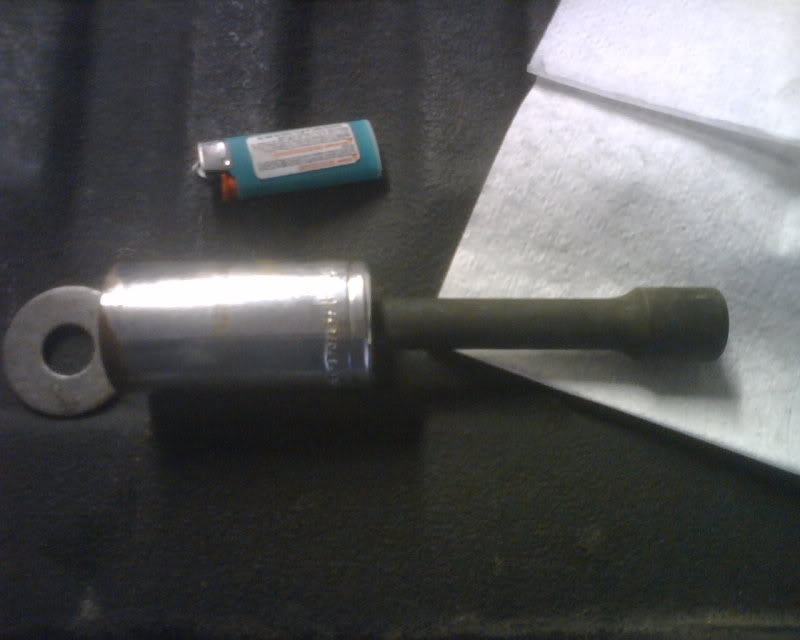

Well, I havent seen alot of DIY's on how to fix the spare tire carrier / winch that always seem to go kaput, so I thought I would do a quick little run-through, with bad cell pix, on how I fixed mine...
First you need a big ol socket
Then some heavy washers that fit in the socket, with a few stack in first to get the right gap. (the lighter will come into play later, dont you worry)
Put in like so.....

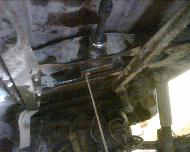

Take 3 straws, make one super straw, stick your WD40 straw into that, and spray the daylightsout of the winch, then go grab your impact gun and extensions
Push the socket with washers onto the winch slot, connect the extensions you need, from behind the body, and start zapping the winch, forward and back, as a friend sprays the heck out of it.

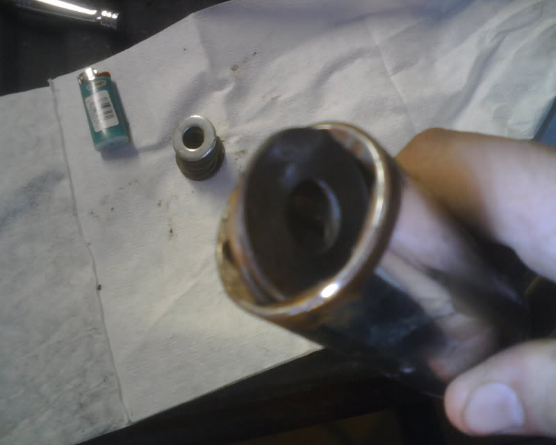

Well, that was easier then spending $50 at a wrecker, or $100 brand new....

And the Felatio! Your Done! Grab above mentioned lighter to smoke your fav cigar/cigarette as you marvel at how frugal and cheap you can be!

After spraying some WD40 up into the winch, working it a few times, mine can now turn with one hand quite easily.
I will be putting a grease nipple on mine, to make sure I can always grease it, and insure this will never, EVER happen again.
