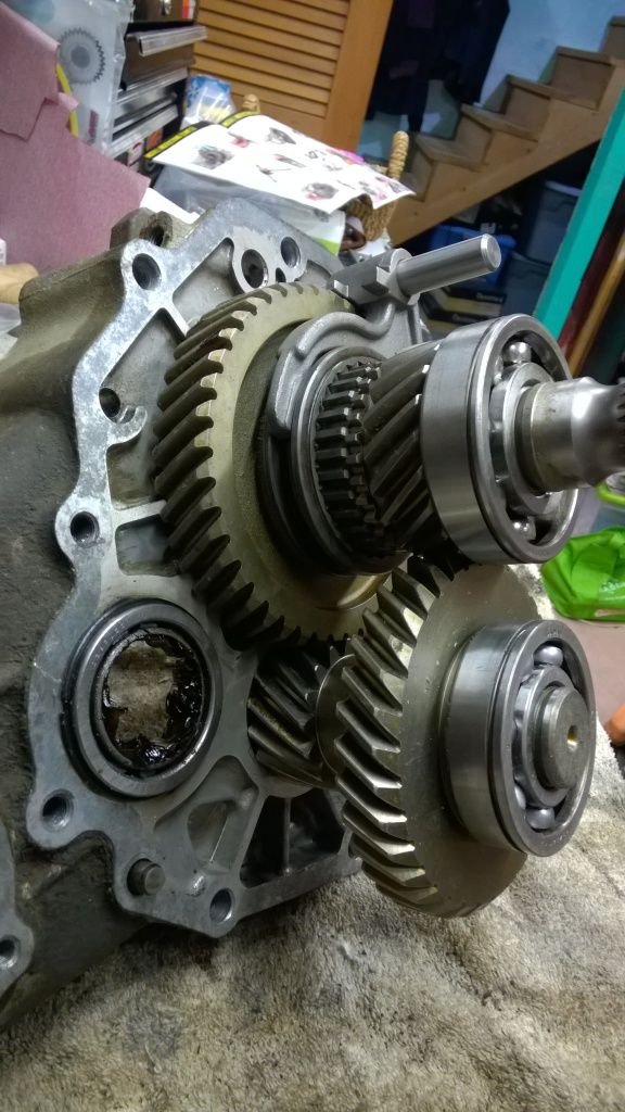

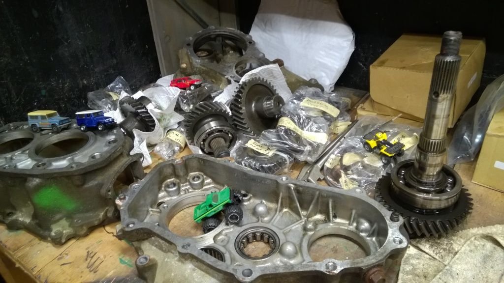

If you took a t case apart youd see why its impossible. There are no gears involved with 1:1. The input shaft has a slide collar that locks onto the output shaft that runs all the way through the case to where the driveshaft flange attaches.
All the gears are for low range and front wheel drive.
output shaft is standing vertically on the far right.

I want to make sure I understand what I'm looking at correctly. Picture one is high/low, and two is 2x4/4x4? When slow moving rigs are put together are the gears in the high/low actually being changed? Or is it just the affect of stacking t-cases? I always thought the gearing was being changed.

So you want to remove the low range gear set (yes, picture 1) and install an over drive ratio?
Its a non syncrod straight cut collar shift, so make sure to double clutch it. Haha. High speed shifting may not actually go so well.
