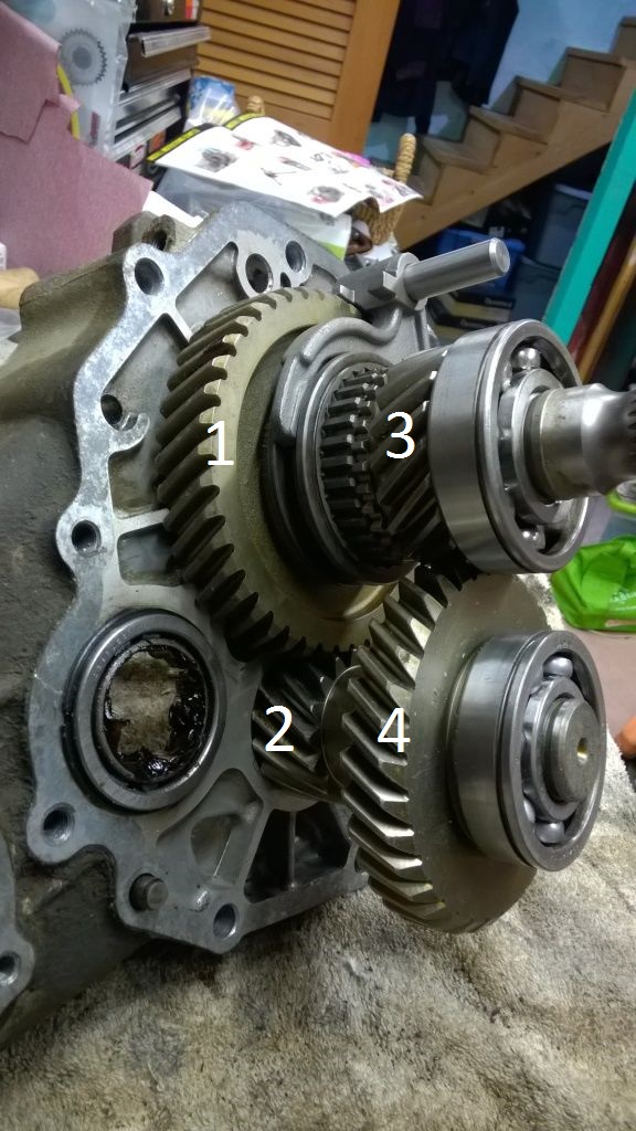

Originally Posted by skullhead690
I completely forgot about this part. Are you talking about flipping 1/2 and 3/4? So that 1 is on bottom and 4 is on top?
Attachment 107373
yes, reversing these will give it a big overdrive. There a problem however. If you put number four on the bottom it's not going to fit in the case. The forward gear is smaller so you will need two sets of the first gear set to fit the case dimensions. That will get passed the first interference.
Second interference will be the central housing, some of the stiffener ribs might need milled down.
looks like a third with the idler shaft bearing, which needs recessed more.

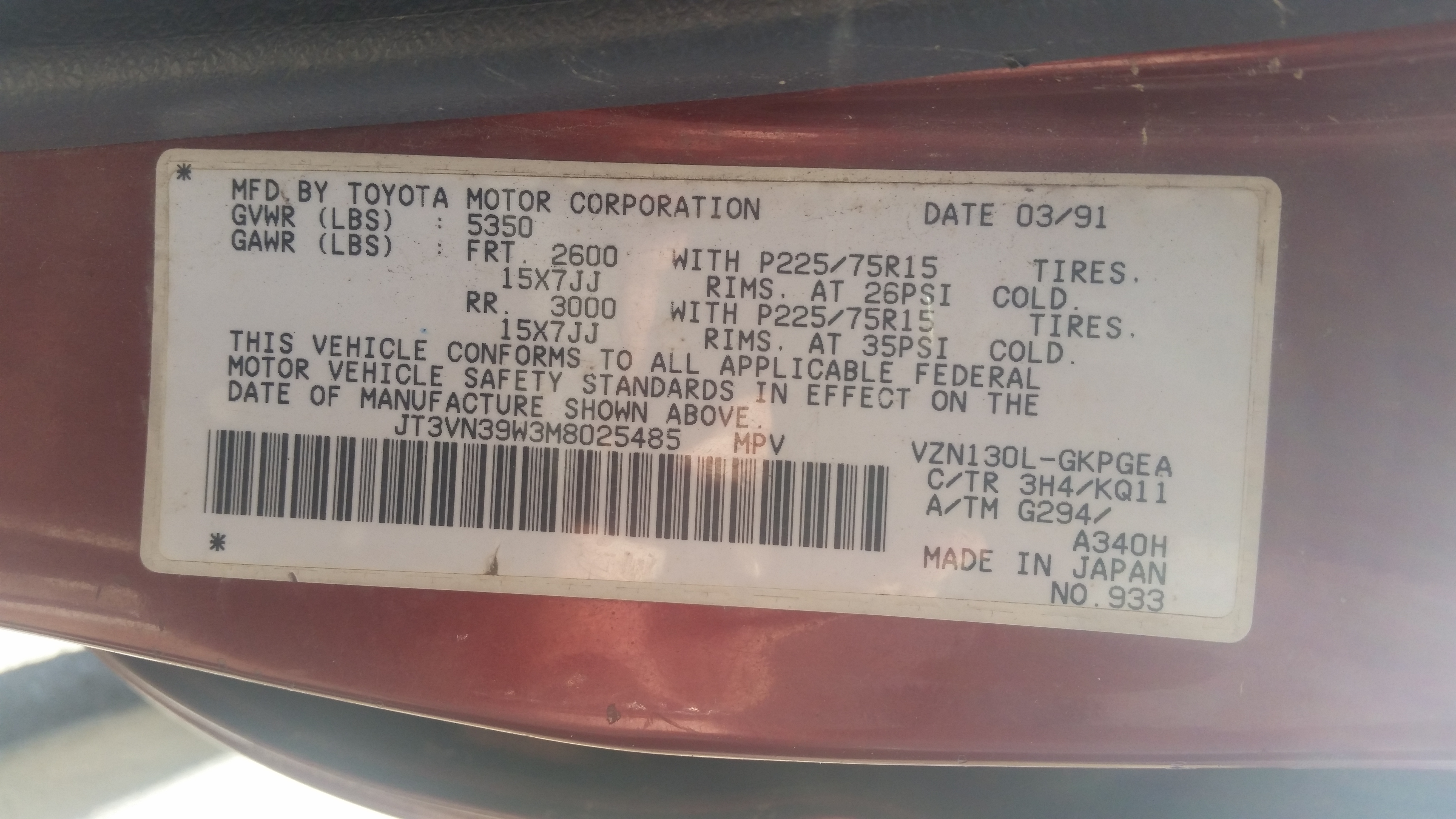

I think the intent has been lost along the way. These would be beneficial in a scenario where i would be stopping. My intent was for this to be useful during highway driving. When the vehicle will be in constant velocity. and to answer some previously mentioned questions my vehicle did start with the smaller tire set. Here is the door side sticker to verify this.

It has been proven that the door sticker isn't as accurate as you'd like it to be. A vin check for the towing package and what gear ratio the axle is would be much more accurate. G294 axle code suggests (not 100% accurate either) that it has 8in ring gear (V6 3rd member), 4.10:1 gear ratio with 4 pinion (also V6 typically). You can also climb under and look at the ribs along the side of the 3rd member. If I remember correctly 4 ribs = V6 housing while the 22re would have the 3 ribbed in most cases except 1 tons and the turbo trucks.
