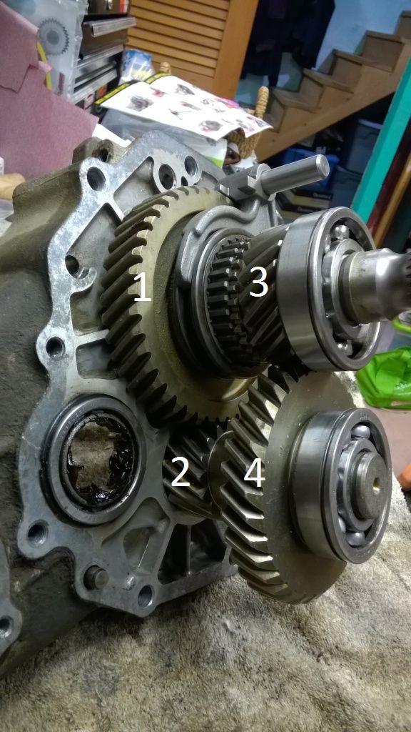

So you want to remove the low range gear set (yes, picture 1) and install an over drive ratio?
Ya, why not? If I can have a dual t-case, one for overdrive and one for crawling why wouldn't I?
Its a non syncrod straight cut collar shift, so make sure to double clutch it. Haha. High speed shifting may not actually go so well.
One problem at a time. If I can get the gearing to work, getting it to shift correctly is the next step.

I completely forgot about this part. Are you talking about flipping 1/2 and 3/4? So that 1 is on bottom and 4 is on top?

I think I understand your plans as wanting to use the transfer case as a sort of 6th gear. The older transfer cases don't like shifting at high speeds so much, tacoma based ones can do so upto 50mph (owners manual spec). I think the older trucks it's 35mph. Realistically speaking, I'd think best usage/application if it does work out is to put it in "super high range" and drive it as a 5 speed with nets out to be basically higher geared axles or over sized tires. You'd also want to add an inline switch to disable the 4wd ADD VSV valves (or splice both vacuum lines together to keep the axle unlocked for testing). Shifting the transfer case at speed w\o the front axle being locked in might allow for higher speed shifts (no front drive shaft would be best case, but unlikely you want to convert to 2wd lol).
Realistically if I were in your shoes, I'd look into the option of reversing the transfer case gears (buy a spare and bench test or w\e). If you can swap the OEM ones, you should be able to swap aftermarket. Turn the low range into overdrive range and try it out. It'd be much cheaper than dual cases, no extra fab work (drive shafts etc) to deal with. If all works out well, then look into dual cases to keep your standard low range while also having the modded overdrive range.
This is defo a neat thought exercise. About the closest thing I can think of to achieve your goal is a engine/trans transplant with a 6 (or maybe 7) speed trans, but I don't even know if their overdrive is any extra overdrive or not. You'd be wanting something like 0.6-0.7:1 I'd think. Also just to point it out, RPM isn't everything when talking MPG. Efficency of the engine (power output vs fuel input) is generally around 80% load at the given RPM. In a perfect world with no hills, no wind, and drive line always being an exact load, you'd have a target speed (say 55mph), figure out how much drive train/tire rolling resistance, and areo drag will be, and get the exact HP rating you need to keep the speed with the 80% load in mind (80% load is NOT 80% throttle). Generally speaking it takes something like 15-20hp to maintain 55mph, so you'd need the rpm that gives max HP of somewhere around 25hp.

I'm pretty sure that is OP's idea, it keeps the same distance apart from the gears, and reverses the gear ratio. I'd guess it might be possible to switch. I haven't done the math to figure out what gear would be ideal to shift to from 5th to the custom 6th, just guessing with ~2.7 it would probably be 2nd or 3rd + the transfer case in "low" with the reversed gears.

My reasoning for dual cases is to maintain my crawling capability but also to facilitate on the ease of shifting. Having two different neutrals may take some pressure off of shifting. I would also be planning on a triple stick mod so as to separate my 4x4 from hi/low so Im only affecting my hi/low settings.
On the subject of tires I believe im currently running larger than stock (please forgive me I don't know much about tires), this size was on it when I bought it so I just stuck with it. 265/75/15
Id rather stay away from a secondary/different transmission just because of fab requirements. This idea just seemed a little too convenient to pass up.
Of course I wouldn't plan on using the t-case overdrive for much more than just coasting. If I needed to downshift I would shift out of overdrive and back into a standard gearing. Im fairly proficient at shifting and gearing/clutch control so Im sure I could figure out how to work it, even if complex.

I looked up some info on the transfer cases, and the V6 transfer case should be 2.57:1 ratio in low range. so just over 2.5 turns of the output shaft per turn of the input shaft is still quite an over drive (1.33 per turn of the input with a trans of 0.75:1 overdrive ratio). My fear would still be the transfer case being the weakest link. Might sound like a lot of effort, if you do get far enough to test drive, I'd say atleast get a way to monitor the temp of the transfer case while in overdrive. You might have to install a couple of lines in the case and add an inline pump and cooler to keep heat down enough. I'm sure there are some extreme off roaders that have done similar so there's probably a write up somewhere on it and what works.
The more ideal ratio sounds to be the ones that came with the W/G series transmissions. It would be 2.28:1 ratio would be a little less of a major overdrive, and another transfer case to research if what you have doesn't work.

With the R150 ill have to trade my current t-case over to the W/G series t-case since (at least according to marlin crawler) there is no adapter for the R150 chain driven t-case. And I would be inclined to trust that information. In marlin's dual t-case kit they provide 23 spline input/output shafts for the w/g t-case(s), do you think that would take care of any of your durability concerns?

Since I would be trading over to the w/g t-case the gearing would be dropped a little like you had said. I had planned on putting temp sensors in the t-case to monitor things while in overdrive. And if necessary an inline oil cooler is definitely an option.

You cant just swap gears on a shaft, youll have to make or have made the gear set for the tcase overdrive. This is what the low range gear set looks like not installed. The bearings come off, but thats it. Youll need to make a new "high range" gears and input gear, so you might as well have it be 23 spline.
You just change out the whole case. Put a gear drive case in, there are adapters for that.
Dont remember if ive posted this link before: http://www.4x4wire.com/toyota/faq/parts/
If your thinking about going to an r series, the r154 may work for you. It originally came behind a 3.4 has a little taller 5th gear. .753 vs the r150 .838
And thats something i was afraid of, based on that info i would be inclined to believe that dual transmission may be an easier route. I appreciate backing up what youve said with visual reference. Deffinately much easier to understand than just its impossible.
ill do some research into dual transmission to see what to do next. but im still going to try and exhaust the dual t-case overdrive just to see if its possible. thanks guys!
