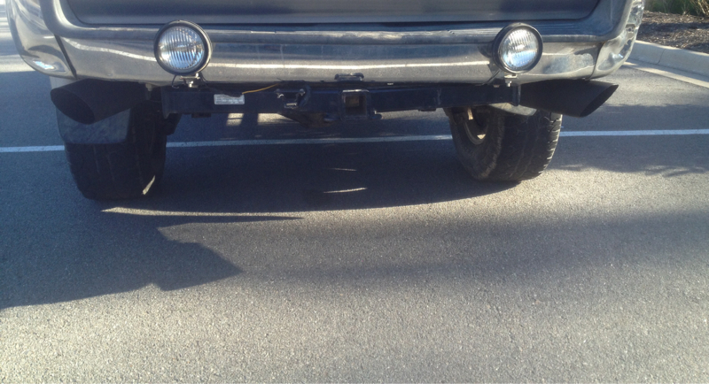

I have duals on my 3rd gen. 4runner with a flowmaster 40 single in dual out with 2" pipes going to 4.5 tips.

First....2.5" is too much IMO for even the mighty 3.0 (never mind the 22re). Mandrel bent 2.25" is perfect (and 2" is perfect for the 22re). You need exhaust velocity and scavenging. This is what helps the entire powerband and keeps the low-end torque, not overall diameter.
Too large an exhaust only helps for high rpms only and sacrifices everything else.
Think of it this way. Lets use GM trucks as an example. They have a bazillion engineers and a mega budget they throw at their design. The 2013 5.3L V8 in the 1500 has 315hp and 335lb-ft of torque. Guess what....a single 2.5" pipe.
Going to true duals on a 3.0 would be silly. Just to make it function the total exhaust area should remain the same as a single pipe system. An oversized IMO 2.5" pipe has a cross sectioinal area of 4.9". A true dual setup with the same area would use two 1.75" pipes.
So unless you want to give up a ton of ponies or sound like a civic with a trash can muffler with duals, stick with 1.75" or smaller pipes. That will look really good wont it.
Just go with a mandrel bent 2.25" system and be done with it. Best performance possible throughout the entire RPM range.
