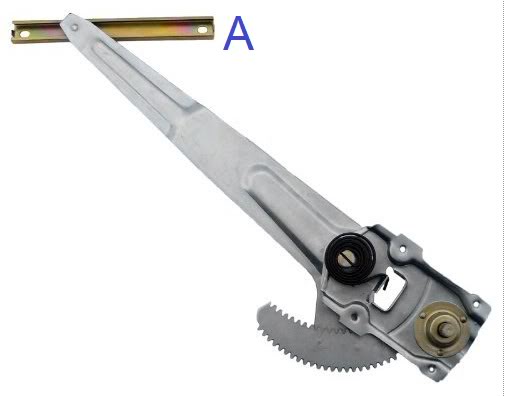

Reckon you already know what it looks like but here is a photo for everybody else.
This is the 80's version
And a replacement howto link
And the 90's diagram. LINK
Should be able to tighten up the rotation points with a hammer and rivet punch, but thats just an assumption on the lower(spring) one it might be a thru bolt to a nut. Pretty sure there is a bushing inside the spring that might be worn. If the rivet or bolt has torn out you can hammer weld and file it back into shape.
For the cost I'd try a hammer adjustment, but if you can't fit your hands in there easy you might be best off just replacing it.
