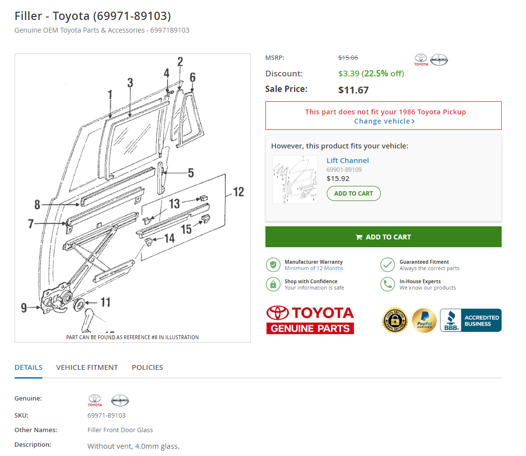

My door glass separated from the manual lift on my 86 pickup. There is a metal u shaped piece that holds a rubber u piece that grips the bottom of the glass, It separated. If i can buy a new rubber piece, I think it will go back together. The original is hard and cracked. I deep dived on the parts lookup and I am not finding a part number. As it might be clear, I am not a glass guy. There may be a correct term for part that grips the glass. I found one thread on the forum with this separation issue, but they were able to re use their grip.

Call a glass shop as it could be a universal fit/shape that is cut to length. They would also know what adhesive to use on the rubber and glass.

Thanks for the part numbers, I was able to use the part number 69901-89108 to research the problem. I found this: https://www.yotatech.com/forums/f116...runner-216063/ Looking in to this pn: 69971-89103. It is not entirely clear, but the new number may be too short for a non vented window. I suspect the new part, 69971-89103, that is described as filler, may require adhesive also.

From this dealer site it says that new part number 69971-89103 is for a "without vent" door.
You might want to add in your vehicle to confirm. I just did a quick part number search on my 86 2WD trunk vent window, so it saying not fit make sense.

My truck is a JDM Hilux Surf (pretty much identical to the US market 4Runner except for the steering wheel location) Mine also has the metal U channel with the rubber filler. NO adhesive is used in the factory - it's friction fitted.
You need to remove the channel from the door - it's held in by 2 boltswhich are accessible when the window is wound about halfway down. Slide the rubber filler onto the base of the window, then slide the filler and window into the U channel, then reinstall it all.
If you don't have the triangle vent window, the part number you need for the rubber filler is indeed 69971-89103.
Hopefully your U channels are in good condition. Mine were very rusty (probably why the glass fell out) so I had to find good condition second hand ones as Toyota don't make them anymore.
