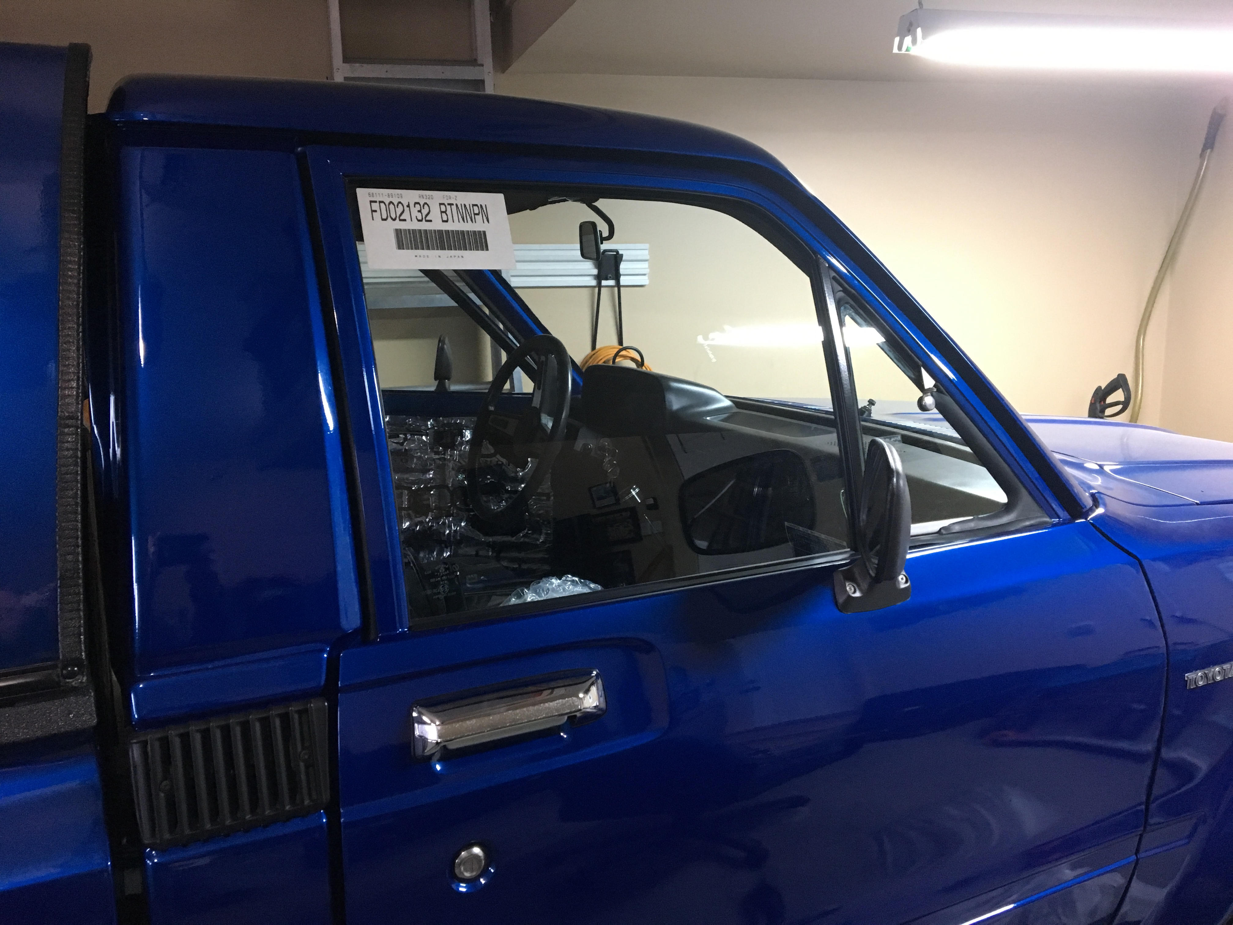

These guys (https://www.vintageglass.com ) are sending me new OEM glass for both doors on my '82. Once they arrive I'll let you know how they are.

So my glass came in...new OEM glass for both doors (1982 4x4) from www.vintageglass.com $95/ea.

Old Dec 17, 2017 | 10:56 AM
medicmoose's Avatar
Joined: Apr 2014
Posts: 126
Likes: 6
From: Kamloops, BC
Both door glass pieces installed....now I just need to order a driver's side vent glass...good thing you can still get them from Toyota Overstock!

From: Gaston, OR
That's an amazing price for new glass. Love your pickup!
