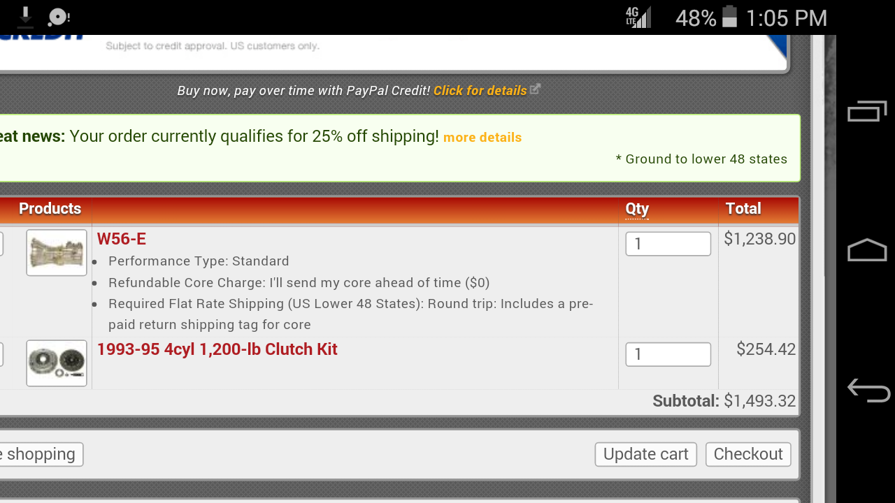

Do you need a Marlin crawler rebuilt transmission, probably not but it's the kind of service and workmanship you should expect because it's a pretty large chunk of cash.
This leaves $1400 for labor and consumables like seals and fluids. There are a few guys around with access to a time estimator, but I'm comfortable ball parking eight hours or more. Depending on your local market that's $100-150/HR easily (shops are expensive to upkeep and most of them would rather knock out a couple of brake jobs and alignment than do anything this major, but I digress), now you've got 2-600$ left for incidentals like fluids, trashed hardware, seals and misc bits.
You can save a little using less expensive parts, I didn't look but I expect a Jasper rebuilt is 10% less which syncs with millball's ~=8-900.
If you find a shop with a lower hourly rate that's another $200 or so, but it's not your usual shop who you presumably already have a trust in.
You can save a bunch and aquire a whole bunch of new toys, er tools, and an experience by just swapping it yourself. Maybe 5-600 in kit if you have to buy everything from wrench's to jacks and stands. There really isn't anything to exotic required with the exception of a transmission jack and that bit is optional although highly recommended because wrestling a transmission into place while on your back dodging loose dirt is no fun.
