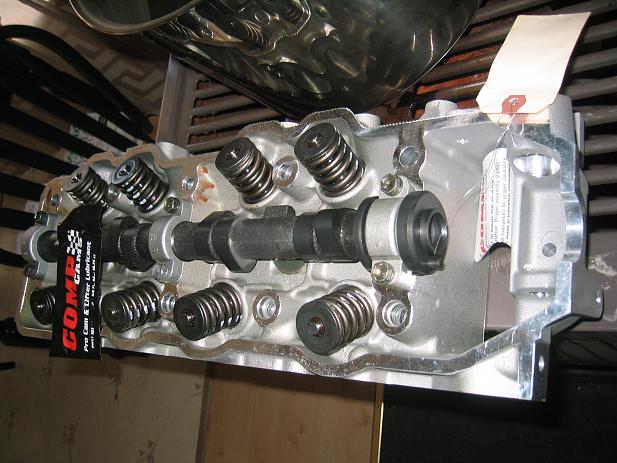

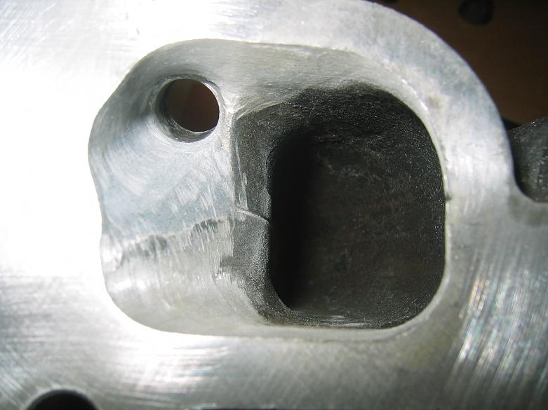

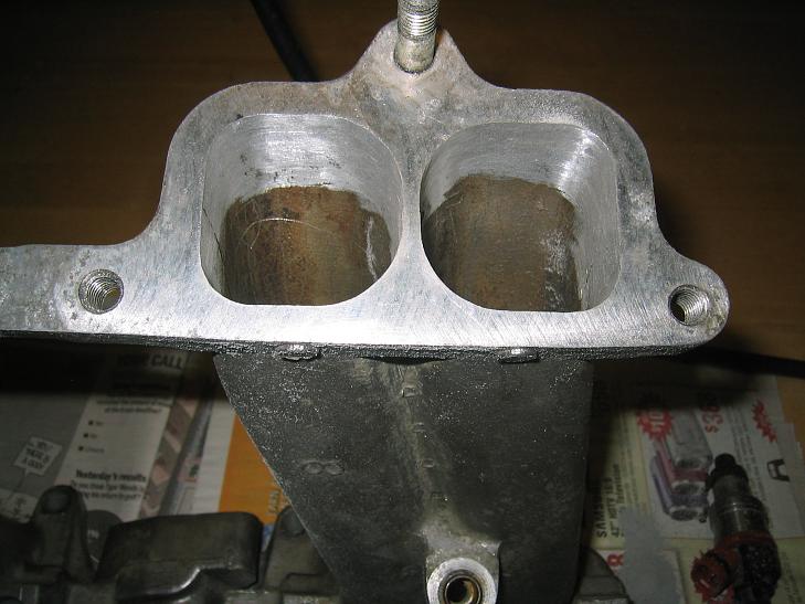

Does the RE count? epoxied around the injectors, gasket matched everything, smoothed out the machining and casting flaws, knife edged the swirl ramps, bigger valves, unshroud machined the intakes only, polished chamber and valve faces, experimented with 'dimpling' around the intake side only. Plenum upper and lower 'dams' removed, TB hole machined to 62mm waiting for my bored TB.

did you do that yourself? how long did it take and what tools did you use? give me any and all details u can please. thanks

It looks like a dremel and a carbide bit is really all you would need to do a p/p on the intake and head.
A guy i knew did a P/P on a ford 302 with just a dremel. The engine ran awesome and had a ton of power, too.

Just a dremel and assorted attachements. The machine shop had a die grinder with extension to look after the dams (I would guess they further mix egr). I don't know what the 20r/22r heads look like, but the 22re is crap, ports wind this way and that- todays technology blows them into the bushes. They are a hemi design- I would have expected better. Even the offshore casting/machine quality is better on the replacements than 1990 oem (I don't know about metallurgy tho). Talk to engnbldr he seems to know what he's talking about. If your a newbie, it's easy to ruin even a set of bad heads- smooth out the casting flaws, don't take too much material off or you kill air velocity. For example- the late '90 Chevy 350 vortecs were very good from GM- guys with good intentions were actually hurting them instead of improving upon. I ordered these bare and had a machine shop fit the valves and make sure the upgraded springs were good.
