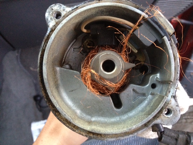

Here's a wonderful photo of my distributor.
Definitely the problem!!!
It was a NEW replacement. He tried used first and got the same trouble with the idle so we went with trying new. New didn't change the problem.
