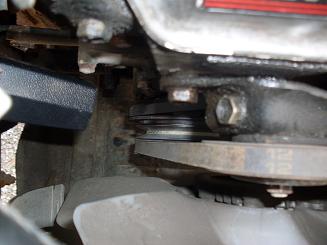

got jumper to work. Ck engine light blinking. Good.- guess I didn't have it in far enough before. being too gentle.
BUT- checked timing and its at the same spot as when jumper is not in- ie. 20*+/- advanced.
At anyrate, I set it to 5*, and it ran like poo, just like when I set it to 5* when jumper was not in. See pics for terminals and timing marks (hard to see).
So I set it back to 20 or so degrees advance. It runs fine like that- helluva lot better than when set at 5* (with or without jumper in). It idles rough now (dieseling or hunting or whatever people call it- backfiring a little bit but runs fine when not idling.)
Why wouldn't timing marks 'change' with jumper in? Light is flashing so its in there correct, right?

Timing marks not changing would be due to the TPS not adjusted properly or otherwise malfunctioning, or the throttle not fully closed.
If you put the jumper in, then turn the key to "on", and don't start the truck, the CEL should flash codes. If it flashes 4 times, short pause, 1 time, long pause, that would be "41"... etc. Once it reaches the end of the stored codes, it starts over from the beginning.
