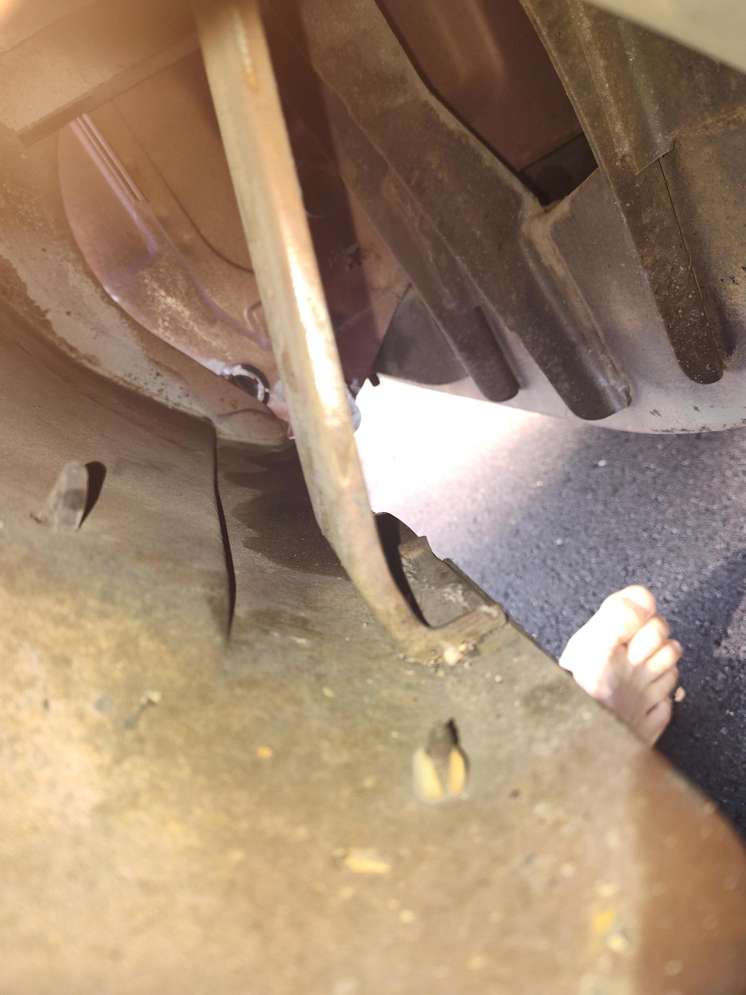

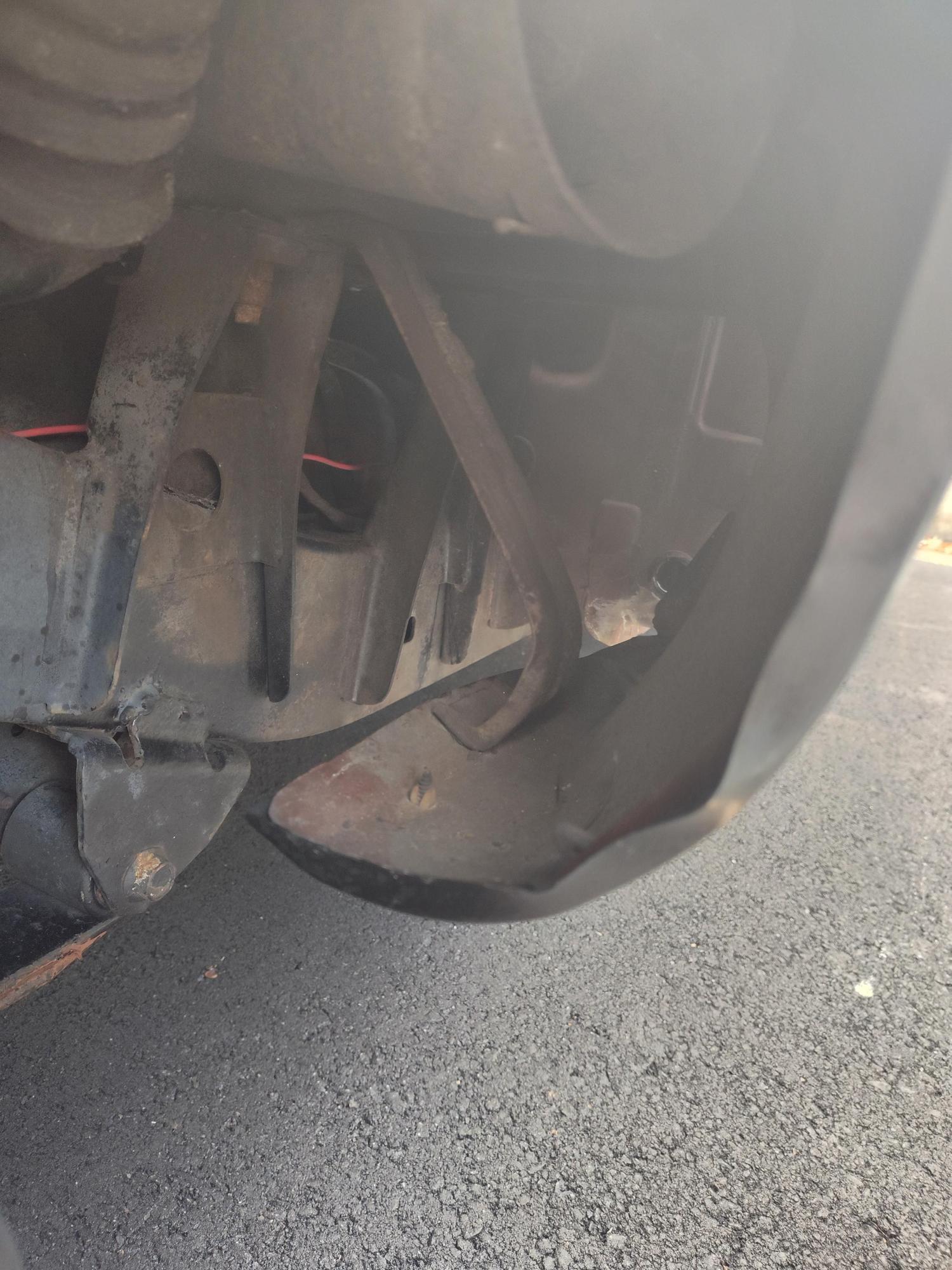

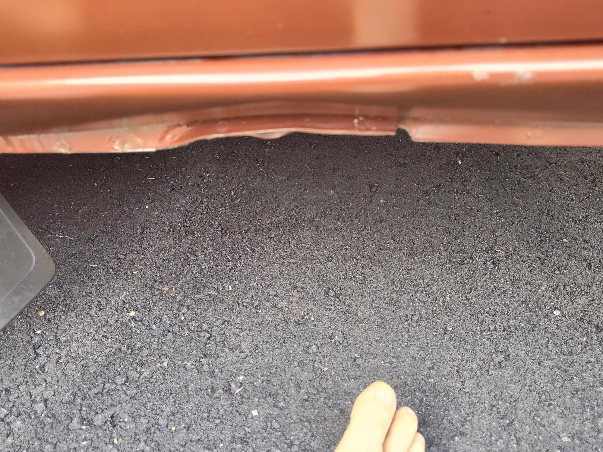

Just a heads up to anyone thinking of getting tires at Discount Tire. While doing my once a year truck waxing where I sat on the ground to reach the lower panel, I found sheet metal damage at each of the 4 locations they used a floor jack to lift the truck.
Emailed corporate and they had local store manager call me. I bring it by Monday to show them the damage.
Passenger rear in front of the wheel with the bracket bent as the sheet metal curled under the truck
Driver front under door behind the wheel

If you could lift the vehicle and get more pictures that would be good. What you need to show is the damage was caused from a force coming straight up, and not from running over something. Take pictures of underside components not damaged; oil pan, crossmember, rear diff, etc. The lack of damage on surrounding parts goes to substantiate it wasn’t done while driving.if bare metal is showing take pictures how it’s not rusted yet.
I’d go to a body shop of your choice (not theirs) and get estimate prior to meeting with Discount.
Don’t let them handle the repair if they offer.
That kind of damage was common with the old in-ground lifts if you didn’t take the time to rack properly. The newer racks have round rubber pads that spread the load to prevent this.
Maybe they’ll take ownership of the damage and be great about it. Just be prepared. Hey, all service depts have bad days. I did. 80-100 vehicles getting serviced per day things were bound to happen. You just own it, make it as convenient as possible for the customer, and move on. Hell, I even fixed damage I knew we didn’t do, but I never wanted my customer to have lingering doubt. Don’t get me wrong, every now and then I told a few to go pound sand🙃

Thanks for the information. I have more pictures from all angles, but only posted a few.
In 37 years this was the 1st tire shop to use 4 floor jacks instead of any kind of lift. Saw the truck up on 4 jacks at the same time as I sat by the 1st bay window where my truck was being serviced. Didn't get there in time to see them doing the placing of the jacks They lifted the front on the pinch welds as if it was a unibody that is structural. The rear just on the sheet metal. The angle support bar that secure that rear sheet metal took a lot of the load, exept the passenger side one curled under. The 4 places are exactly where the jacks were placed. I will take video at the shop showing how all the vehicles are typically lifted that way.
I will work with their insurance agent. In VA we can select the shop of our choice and do not have to go where they say.
So far they have not denied it and have been cooperative. I don't foresee any problems. Monday will tell though. I just hate grossly incompetent workers
