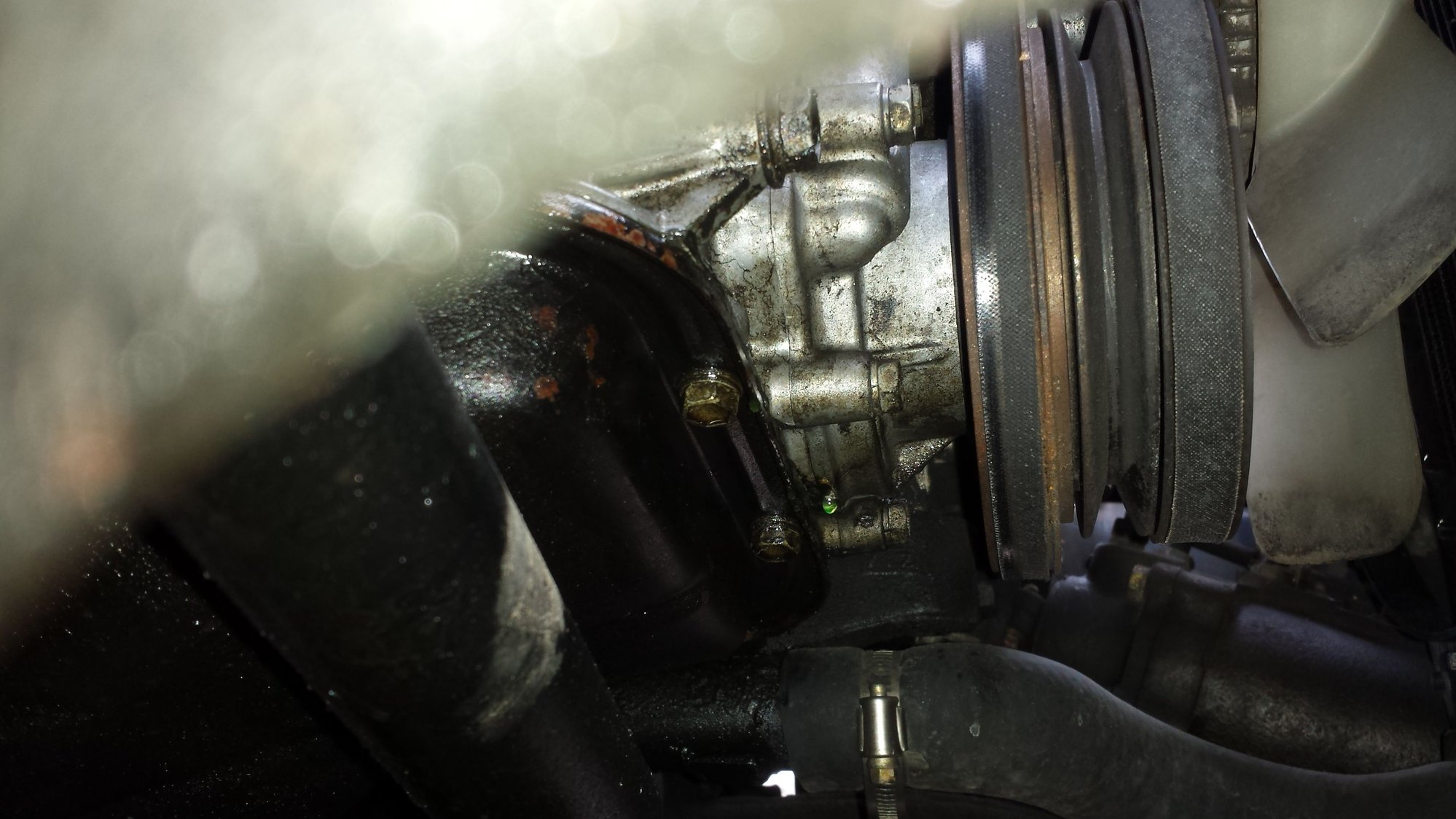

I'm extremely pleased with the results, however during my various modifications I noticed a fluid leaking, and splattering on the upper side of the "forward deflector shield" under the oil pan. Try as I might however, I've been unable to locate the source of the leak, UNTIL THIS MORNING! It's been somewhat sporadic, but today I actually caught it in the act:
That little green dribble (NAPA 50/50) IS the source of the leak, it's not running down the engine, I'm pretty sure it's leaking from the bottom most point on that gasket. HOWEVER, I COULD BE WRONG.
The fluid is definitely BOTH oil and coolant, and I'm quite concerned as to it's origin.
Thoughts? Concerns? Quick fixes?

Look on the top of the water pump for signs of leakage. Does your alternator belt squeal from time to time? Might be time to replace your water pump.

Maybe slightly juicy on top, rather hard to see the bottom (lot in the way) but I did manage to spot a little pooling on top of that front cover piece from the photo.
Two questions:
1. Would a mixture of a oil and coolant be indicative of that? And two, can you recommend a good cheap water pump? I was just looking at:
Amazon.com: Evergreen WP2000 Toyota 4Runner Pick-Up Celica 2.4L 22R 22RE 22REC Water Pump: Automotive Amazon.com: Evergreen WP2000 Toyota 4Runner Pick-Up Celica 2.4L 22R 22RE 22REC Water Pump: Automotive
Thanks Odin, I think you may be right on.
