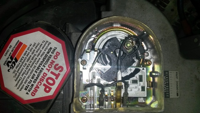

OK I tested the MAF with an ohm meter per the instruction in the link above.
I took the air hose off and inspected it including it's under side. No cracks, it looks fine.
The ohm meter test did not match the spec. When measuring between E1-FC in door fully closed position should read infinity I was getting no reading at all from the meter, is that equal to infinity? When measuring from E1-FC with door in any position other than fully closed it should read 0 but when it was fully it was reading 180. The other measurements between other terminals did appear to match the spec.
I am now going to order the part and hope it cures the problem.

All the readings appear to be in spec except for the E1-FC.
When door is in any amount of open position that reading should be Zero. On mine it reads about 180.
When door is closed it should read Infinity. On mine it reads zero.
I am not sure but I thought Infinity was a fully pegged to maximum/end of scale ( with analog meter like I used) or 1.0 if using a digital meter.

Infinity should be the same reading you see when the probes aren't touching anything. I would think 180 is OK, to me the ECU is looking for anything but infinity or open. (I never liked infinity, confuses my pea brain!)

180 is not okay. it drives the relay coil, so like only 200ma passes through it, but 180 would probably not get close enough to 200ma current to hold the fuel pump on. get a box cutter and slice through the silicone on the cover. i'll attach a pic here but the second (beefy) terminal can be pushed up or down some to get the point contacting in another spot. don't try to manipulate the first tang on the left, just the second, and don't let it rest on the circuit board when done. don't forget to touch the meter terminal leads together and subtract that reading from your reading. do it before and after measuring. less than 10 ohms should hold the coil open, but something like 0-4 is good afaik.
