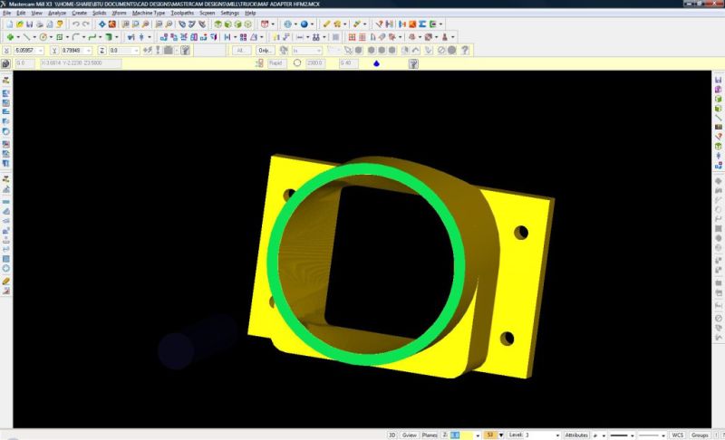

Here is my original design.
First on the list is a wide band A/F meter for tuning.
Next is MAF calibrator.
(see first attachment)
The intake system would consists of these parts.
This is the Bosch 028017120 MAF sensor. (second attachment) It has a 70mm (2.75”) output tube. Same as OE AFM. It was used on early 90s SAABs and seems to be easy to get. I sent the spec sheet to Split Second and the engineer said it would work with there calibrator.
I will use a short length of 70mm silicone tube to connect to this adapter of my own design.
(last attachment)
The biggest problem with this adapter is the round ID has an area of 4.7 sq/in. The rectangular opening of the air box side is 3.9 sq/in. I wonder how much this will limit HP but have no way to figure it out.

This looks pretty good and would be easier to make the adapter. It also has a CARB OE Number. But I don’t now how smooth the air flow is exiting the filter. Split Second has a tech article that mentions that the air flow from a pod air filter is pretty turbulent. I would design the adapter with a nozzle to smooth the air flow. But it would be hard to tell if it solves the problem of turbulence through the MAF.

What do you guys think, good or bad? Any design improvement suggestions?
