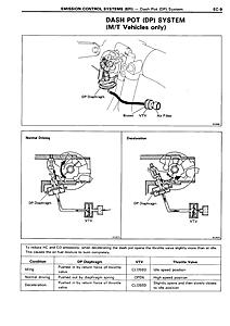

Straight out of the 1988 22RE FSM.

Don't really bother with this one. I've used up 2 of them (the springs and the cylinder fail). I've driven with it off, just with a manual it makes for a very jerky deceleration. If you have an A/T don't even bother then.
I think they are standard on the 3VZE's past 89, every single one I've seen in the yards had one.
