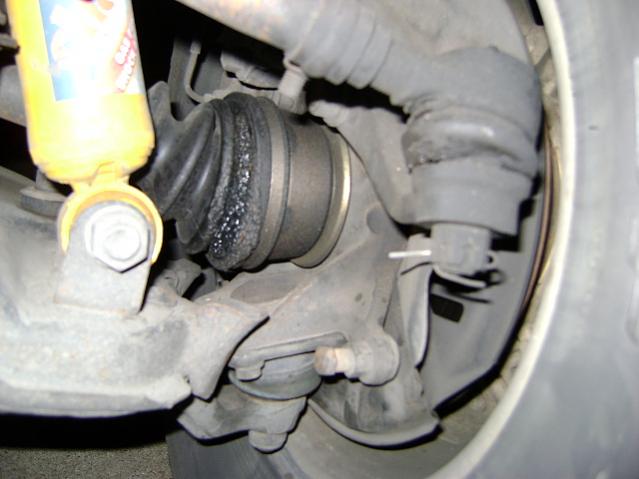

I have a 93 4runner and had ome shocks and springs, bj spacers and manual hubs installed about a year ago. since then it has been in the shop twice because the cv axle on the driver side keeps breaking. When in the shop they tell me its because of the angle so they replace the cv axle and mess with the torsion height. To remind you the passenger side rides with no problems. Could it be that the hub on that side wasn't installed right and therefore causing the cv joint to break? I dunno enough about it, does anybody have any ideas on whats going on here?

How is it breaking? Inner joint, outer, ripping boots, shaft itself ...
Pictures?
It's no biggie to change a CV - definitely not something you need a shop to do.

The outer boot is tearing and leaking all the grease i guess. It sounds real bad though. Whenever going over the smallest of bumps it makes a loud poping noise. I wish i had the knowldge and tools to do this myself. Thats why i call upon you guys who know your stuff and i can know what im talking about when i take it to the shop.

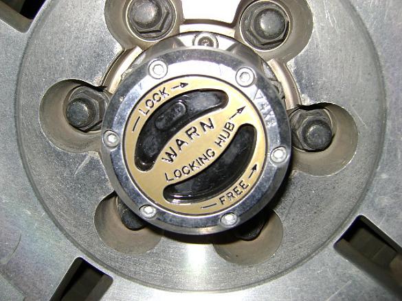

Those angles are steep but the cv's should not turn when the hubs (manual locking) are unlocked. If you have autolocking hubs then something is wrong with them. As the CV's should not turn when hubs are unlocked. I have driven my truck with the front axle removed and the cv shafts tied so they would not dangle about. You've got hub issue or you t-case is in 4wd.

Warn manual hubs. Never been in the locked position.

then it shouldnt be turning the cv's.
time to check the hubs..

Here do this, go under your truck, Leave the hubs in the unlocked way, grab the cv chaft and try to rotate it. Member, leave it in 2wd. If they dont rotate whentheyare unlocked, try the locked position.

It would be unlikely for you to see this rate of failure if the hubs are unlocked, however, with BJ spacers, you COULD be getting too much droop travel and that could be harming the CV's.

Ok. Shaft moves when hubs are unlocked and doesn't move when they are locked.

BJ spacers are supposed to help this type of lift right? Any thing that can be done to get a better angle?

No, Bj's make it worse. Loosen your tbars.

easing off on the t-bars, reducing lift, bump stops to limit droop, a drop bracket. 4crwaler sells a setup to lower front axle.

Time for a differential drop then.
