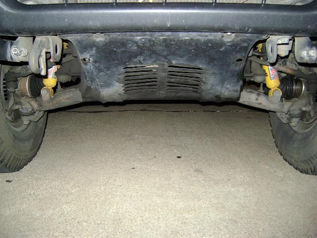

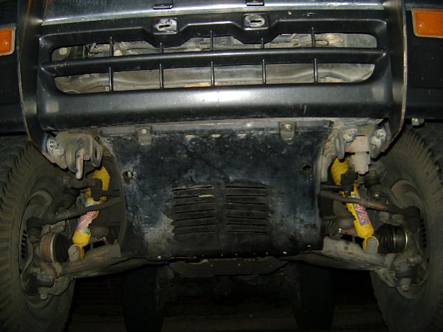

Lets try this, Can we get a pic of the front of your truck, mainly the suspension, the tbars could be cranked giving too big of an angle. So, Take a pic of the whole front suspension.

pics of the front
Attached Thumbnails CV axle breaking. HELP!!-dsc00152.jpg   CV axle breaking. HELP!!-dsc00150.jpg   CV axle breaking. HELP!!-dsc00148.jpg

Yea that is a pretty intense angle.
is the front a lot taller than the back?
I would relax those Torsion bars a bit
when mine was lifted (different style lift)
My lower control arms were just about level with teh crossmember
Old Feb 22, 2009 | 09:09 PM

I bet it rides like a cadillac
yeah bro, that looks like the t-bars are MAXED
it's not unheard of to need to shim the droop bump stops with bj-spacers to keep the CV's from binding btw. But to me, it looks like just the boot is tearing and leaking, and on top of that it sounds like the shop is trying to rape your wallet by saying you need a whole new shaft...

Yea, So you have 2 options, Keep it the same height with the tbars and do a 4crawler 1" diff drop, or lower the torsion bars some. If you dont know how, take it to an alignment shop and have them do it and then align it at the same time.
