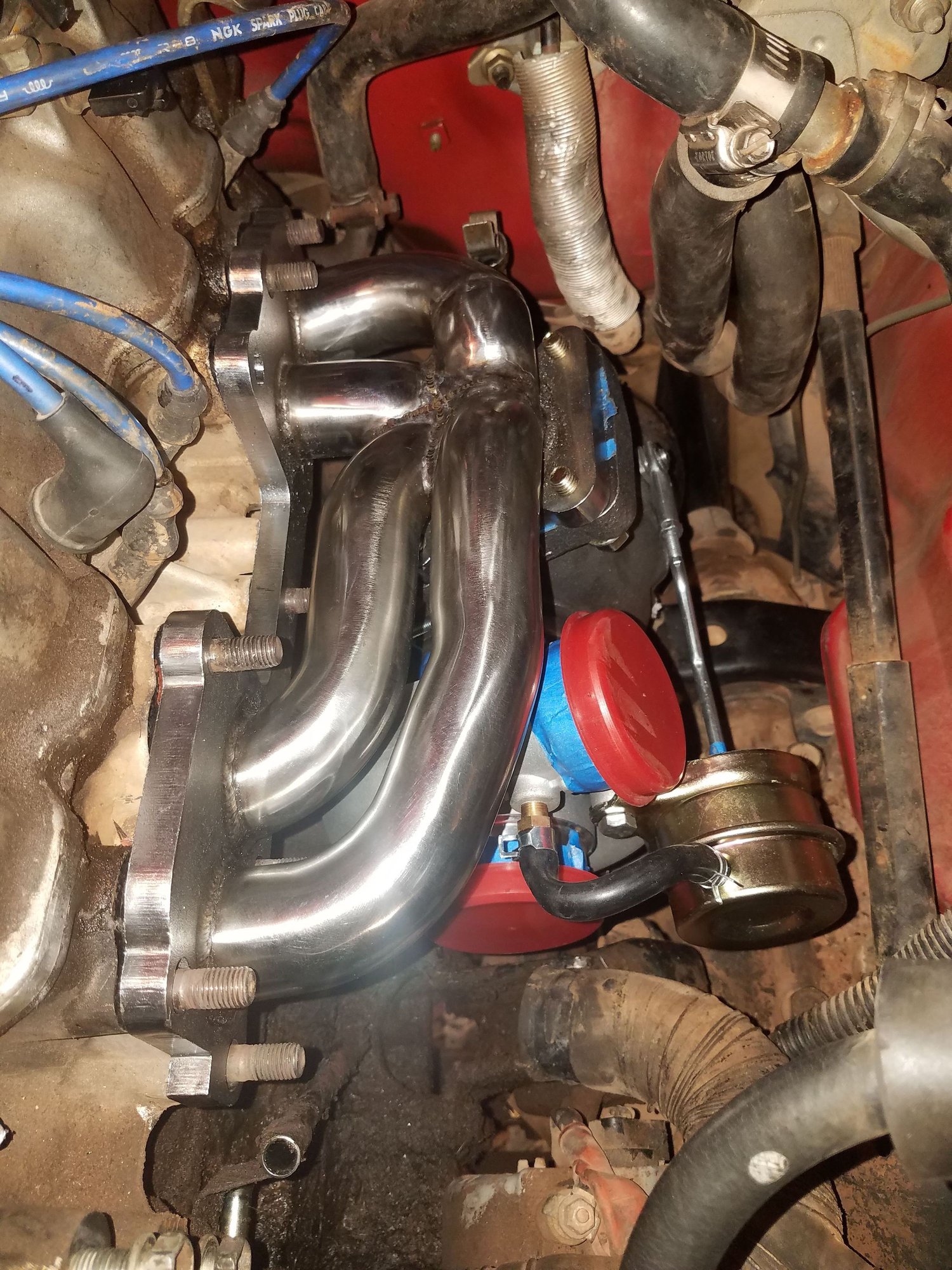

CT26 upgrade
So, its been easier than anticipated...
ALL the lines and studs from the CT20 bolted right up on the CT26...
Reclocked the center section, very simple...
Tweaked the oil lines a little bit to line them up, to where they attach to the block...
the old CT20
The NEW CT26

Yep, just the charge tube and gasket match of exhaust manifold different.

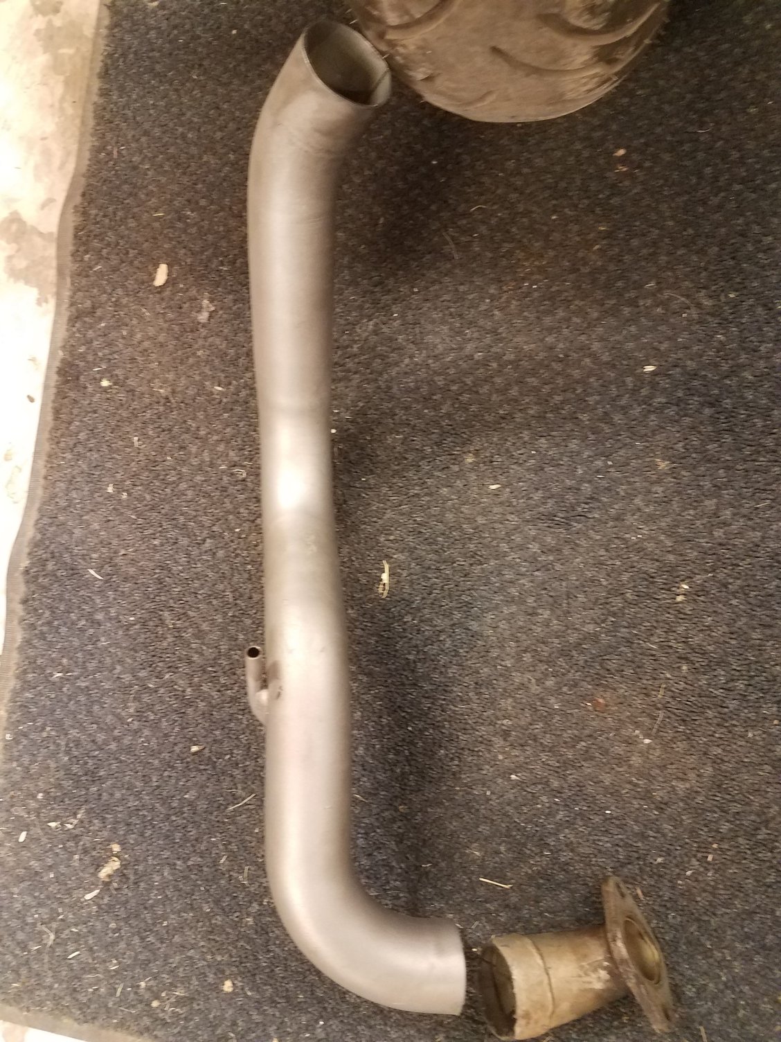

Old Sep 17, 2018 | 11:57 AM
87-4runner's Avatar
Joined: Mar 2012
Posts: 1,139
Likes: 414
From: Oklahoma
Old Sep 17, 2018 | 11:58 AM
87-4runner's Avatar
Joined: Mar 2012
Posts: 1,139
Likes: 414
From: Oklahoma
Got my down pipe finished... woohoo
still have to add the O2 sensor

Flange
That the eBay billet flange?
I still haven't put a bung in my downpipe, exhaust still just running out the wheelwell. Are you going with the Toyota flange style or a screwing bung?
Old Sep 17, 2018 | 01:58 PM
87-4runner's Avatar
Joined: Mar 2012
Posts: 1,139
Likes: 414
From: Oklahoma
the oem flange... the flange was off ebay cnz i think... very nice HEAVY piece... super pleased with it...
my buddy at ramco had a flange for the oem O2 sensor and gave it to me... he's awesome!
ok, i can see that's confusing... the O2 sensor flange IS NOT off ebay...
my exhaust/ wastegate flange is off Ebay...
