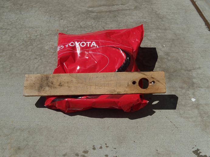

We fabbed up this special service tool imitation to limit the counterclockwise rotation of the crankshaft (lefty loosey-right to tighten) so we could use a jack handle 4' long to get enough leverage on the bolt.
The inner big hole is for the socket, the outer holes to screw a bolt into each side of the pulley. It worked!
Attached Thumbnails Crankshaft Pulley-0410-toyota-special-service-tools-homemade-001.jpg
