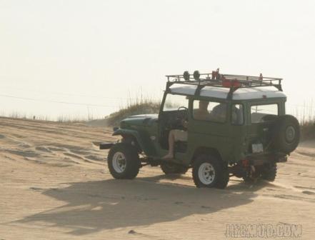

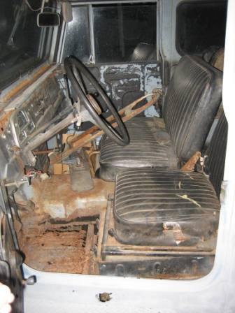

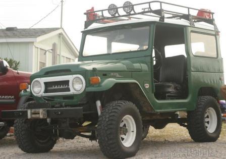

Here are a few.
Will put more on late. Have to shrink them. But first pic is when I got it (not a piece of metal from the fire wall back...rockers gone, rear cab corners gone..you name it rusted. Still has a long ways to go though. Still doesnt' drive worth a crap.

addicted- I love the FJ. That thing looks great! Thanks for posting the pics.
