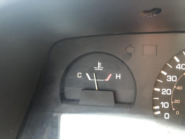

I ended up unplugging the sender and putting some dielectric grease on it, and then pulled the cluster out and tightened all the screws on the back and also greased the connectors and took it for a drive in 105 degree weather and it looks much better:
It looks like where J94's second picture shows?
The KOSO gauge looks really nice, I might go that route if the gauge keeps acting up. Is there any way to T off the wiring for the KOSO gauge so the dash gauge still works?
