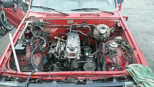

Engine is out! Anyone that wants to take bets on what I find, feel free. More updates to come.
