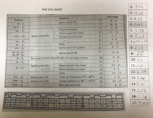

Old Feb 16, 2018 | 03:27 PM
  #114
YotaRick27's Avatar
Joined: Jan 2018
Posts: 167
Likes: 11
From: Rapid City, SD
Ok so here is a voltage test and the resistance test.
voltage test ECU plugged in
resistance test of ECU wires (ECU unplugged)
Thoughts?
Old Feb 16, 2018 | 04:34 PM
  #115
old87yota's Avatar
Joined: Jun 2013
Posts: 3,112
Likes: 582
From: Portland, Oregon, USA
In your resistance readings where you say "No Reading", what exactly do you mean?
OL (infinite resistance)?
Zero resistance?
Not Tested?
Your #1 and #2 voltages look low.
Unfortunately, I have a 22R so I can't compare what I have to your readings. I will let the 22R-E experts comment on the rest of the readings.
Old Feb 16, 2018 | 05:07 PM
  #116
Co_94_PU's Avatar
iTrader: (-1)
Joined: Dec 2012
Posts: 5,433
Likes: 555
From: Colorado
ECU voltage beyond spec, measure battery voltage at the terminal.
Reread first post. Fuel pressure to low, you want 35 and 40psi, you have 31-36.
Low battery voltage, possible bad pump or regulator. Charge the battery, apply jumper-cables or jump box. Retest fuel pressure.
Identify those wires, see below quote. You have some other out of spec things that could be related to bad voltage or typographical error.

^^ I think the goal of this thread is to PROPERLY fix what ever is going on, rather than hacking things up and still leave the problem in the truck.
I do understand when you need to get the truck running again as soon as possible and using a temporary fix or when you bypass things for testing, though.
However, since we don't know the root cause (or causes) to the starting problems, they could cause future problems down the road, even with your modification, since the unknown problem(s) is/are still in the truck.
I would do three things at this point:
  1. Fix the coolant temp sensor/switch on thermostat housing. EDIT: see TSB posted by Co_94_PU in later posts
  2. Check battery voltage (~12.6 volts); better yet, have the battery load tested
    1. Charge or replace battery as needed
    2. If battery needs charged or replaced, rerun voltage tests at the ECU after charge or replacement
    3. If battery is good, do a voltage drop test from battery positive to BATT terminal on ECU and from battery positive to +B terminal on ECU. Ideally, the voltage drop should be around zero. A significant voltage drop means there is a wiring or connection problem and the ECU is not getting the proper voltage it needs to operate.
  3. Check for cause of low fuel pressure
    1. Fuel pressure regulator not allowing enough pressure?
    2. Not enough voltage at the pump?
    3. Old, weak pump not able to produce needed fuel pressure?
    4. Clogged fuel filter?
