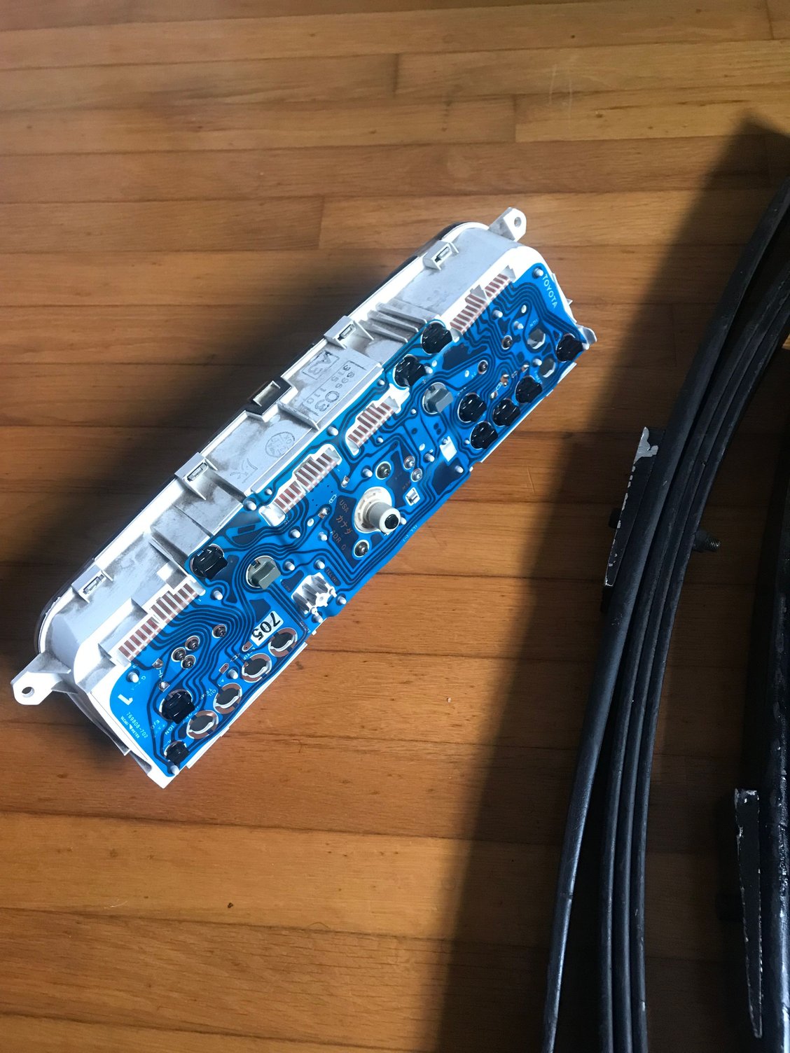

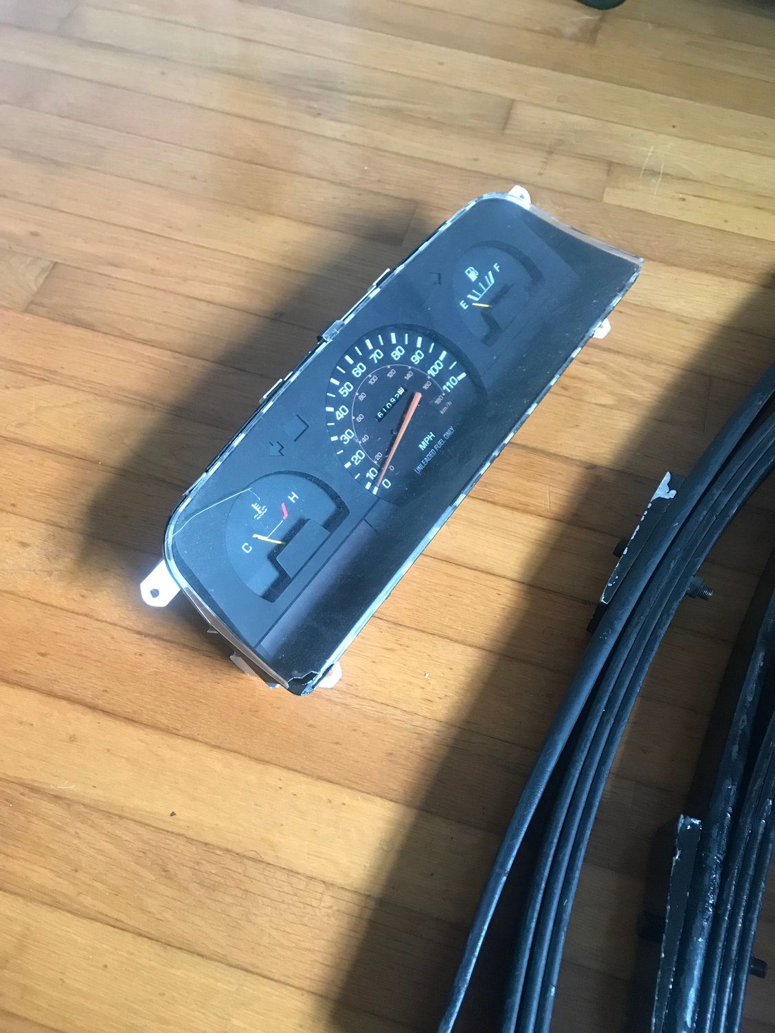

I had the exact thing happen to my 3vze pickup, you need to replace the whole gauge cluster. My truck would start "surging" or cutting in and out around 30-50 mph. It was the oddest thing and it threw code 42 if I remember the VSS code. I replaced my cluster and it stopped having that problem.

this whole gauge cluster is what you need to replace. they are usually on ebay for not too bad a price, pretty simple replacement just have to take apart some of the dash around it carefully, some screws bolts, and unplug, replug the new cluster.

Yoti808 has the combination meter ("cluster") that goes with a cable speedometer. Mine ('94) has the electronic speedometer; I can't tell you which models or years have that.
The cable speedometer has VSS1 inside the cluster (just a reed switch.) The electronic speedometer has a Hall-effect sensor mounted into the back of the transfer case as VSS1.
Just figure out which one you have. From the back of the transfer case, you either have a speedometer cable, or just wires.
