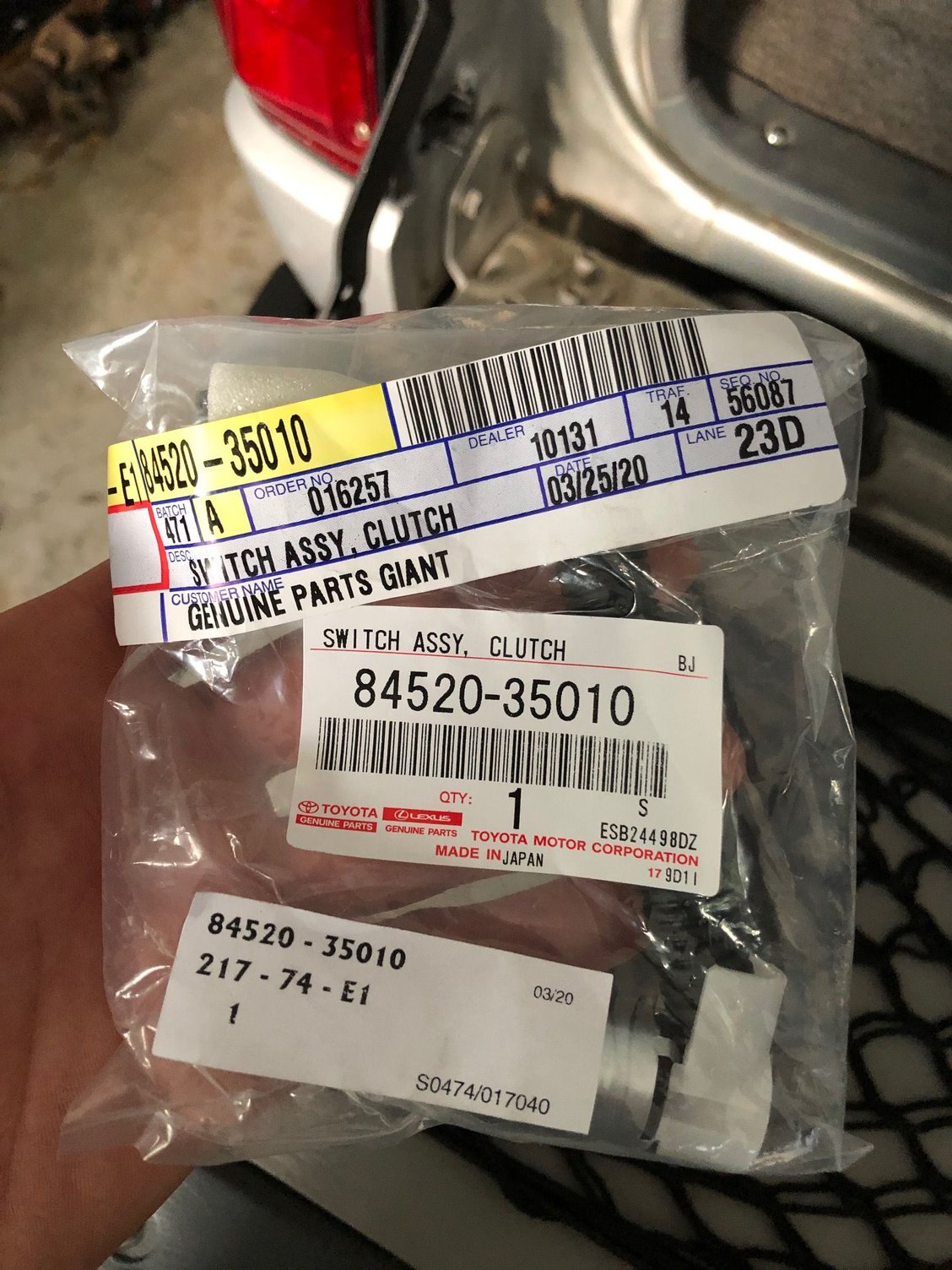

my clutch switch had been giving me intermittent problems, every now and again it wouldn't work at the pedal assembly so I would have to use the dash cancel button. ordered a new one, not expensive actually. replacement is extremely straight forward although I will say that I used more than a couple profanities trying to get the plastic connector apart. the clip sets deeper than you think, I had to use a small screw driver and press it into the tab to get it undone. theres a 14mm nut and locknut on the threaded portion. my new oem part did not come with two nuts so I reused one of the old one. I counted the threads to make sure it was positioned the same on the pedal. a dab of dielectric grease on the new connection. upon installation I noticed that the bracket holding it in place was slightly bent, so when the pedal bump stop hit the switch it wasn't aligned perfectly, this may have been the issue the whole time. I bent it back into place about 1/4" and depressed the pedal by hand to ensure alignment. part number for the switch is 84520-35010
