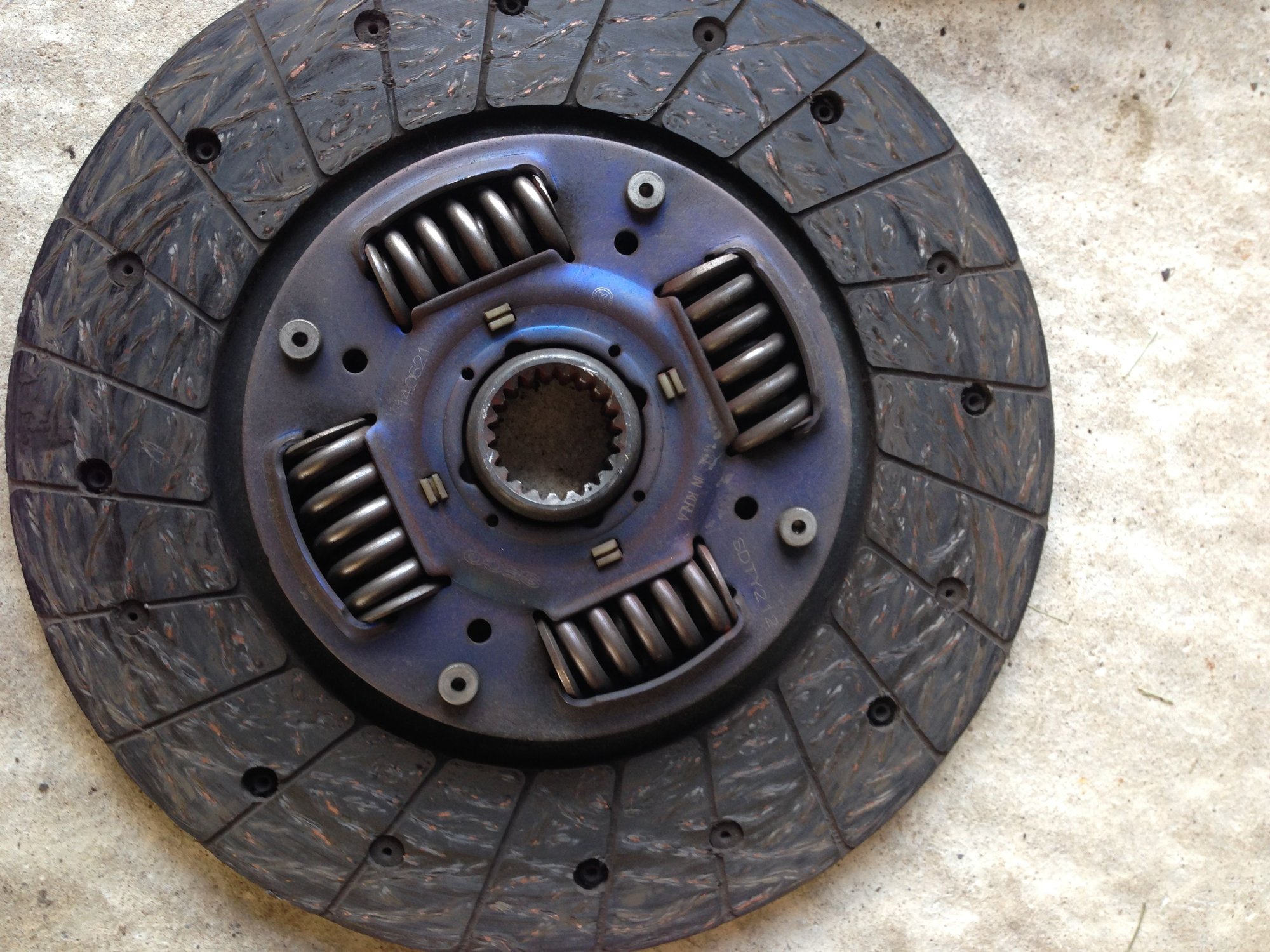

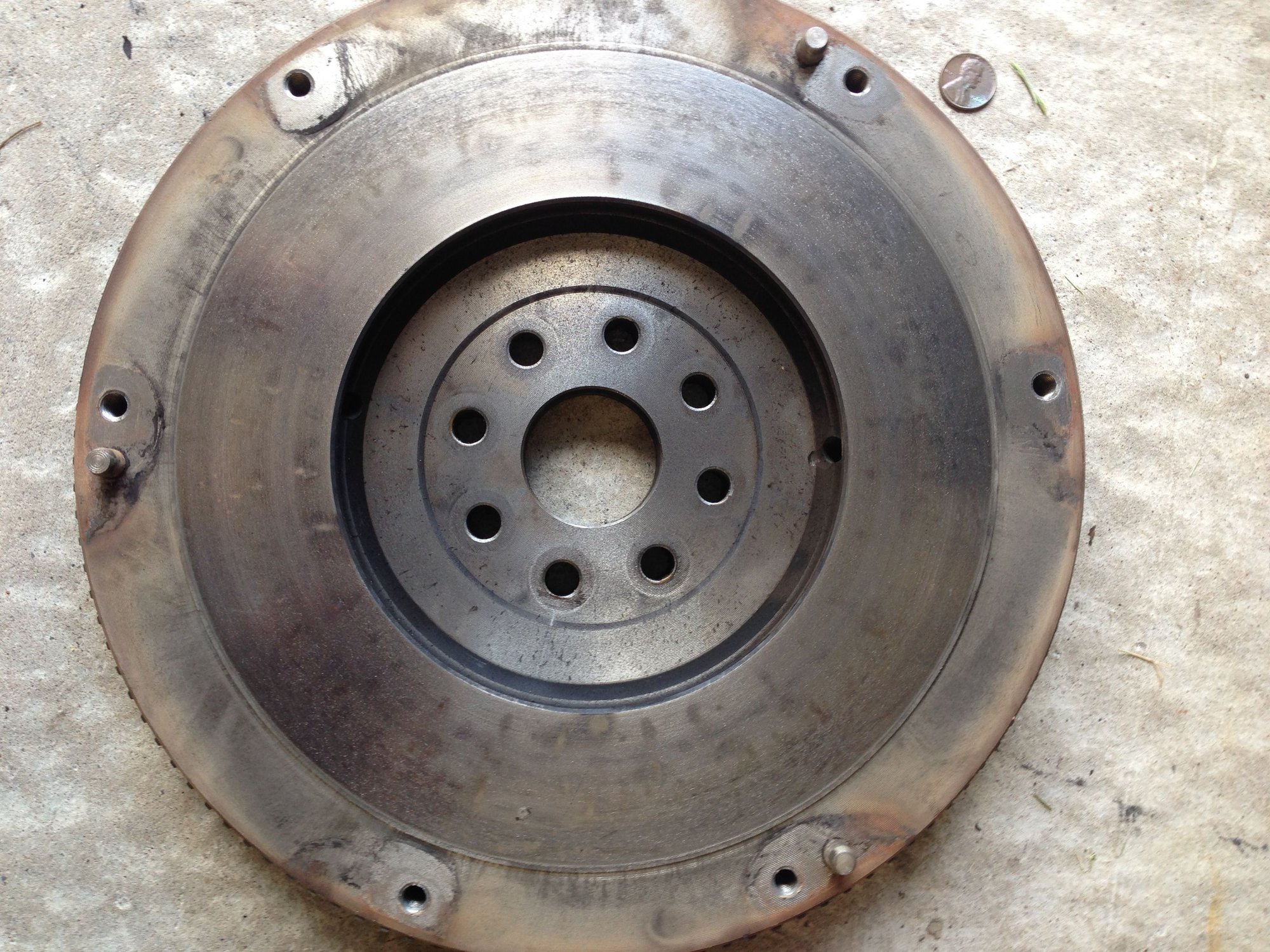

Clutch it
So I took a few pictures of the clutch and fly wheel out of the 95 4Runner 3.0. The rig has 240,000 miles on it and I suspect this is not the original clutch.

Nice pictures !!
I think most of us have seen something similar and some of us way to often
My rule of thumb on my vehicles is if the transmission comes out a new clutch goes in.
Exceptions are if the transmission comes out the same day or within 5000 miles or less
Or if I decide to break down and Buy a Marlin Crawler Kit even though nothing is wrong with the Aisin Clutch now installed

When you replace the clutch, make sure the spring fingers on the pressure plate are all aligned with each other. The FSM says to within .020". If they are misaligned, they'll put a rotating rocking pressure against the throwout bearing, causing it to start wobbling on the transmission quill. Then it will start squeaking and drive you crazy, because it only squeaks when your foot is off the clutch pedal - in other words, most of the time.

Normally I would say might as well change it when you can. However this one doesn't look to bad and I am kicking the idea around of re using it.

Doesnt look to bad. Maybe the fingers on the pressure plate are iffy. My 93 with 465k km on it is still on orig clutch. Mind you its a 22re.
