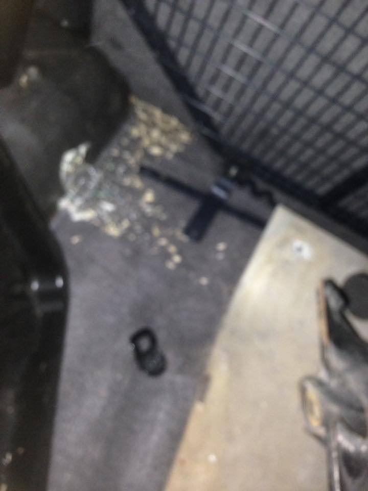

rear cargo area - I think you can see a tether anchor
blurry pic of mouse carnage and tether anchor

The above is the only correct way to install a forward facing car seat Ina 1st/2nd generation 4Runner. The part cost $12-$18 from your local dealer. If you have the strap routed any other way or attached to any other position you need to consult your car seat manual ASAP! Your child's life could be in danger and you could be held liable in the event if there death.

QUOTE=cbr600rx7;52334768]
The above is the only correct way to install a forward facing car seat Ina 1st/2nd generation 4Runner. The part cost $12-$18 from your local dealer. If you have the strap routed any other way or attached to any other position you need to consult your car seat manual ASAP! Your child's life could be in danger and you could be held liable in the event if there death.[/QUOTE]
Thanks for the Pic of the part with the part number.
That part is what I used as well. The 4Runner was only use 21-2 times with child seats. Then the 4Runner went into storage.
Now they kids are like 9-10 (but are small for their age - so they are in boosters) and they have NOT taken a ride in the 4Runner.
