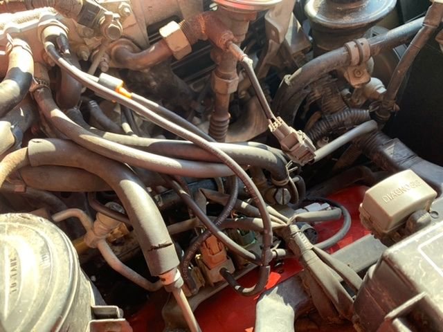

Well I reset the light. While under there I checked the vacuum lines and found based on a diagram that it’s possible one was crossed. So I corrected that. Hopefully that’s the end. But while under there I did find this “T” line that I don’t see in online diagrams. Anyone know what this is going to or what it does ?
Thank you all for the help.

The vacuum lines connected to the "gas filter" (the 3-port gadget mounted on the plenum) drive the PAIR, FPR, AC idle-up, ADD, and Cruise. You only have two ports used, so I'm guessing you don't have 4wd or Cruise. The orange-white check valve goes to PAIR, so the tee most likely goes to FPR and AC idle-up. You can trace them; that's not much more I can tell from your photo.

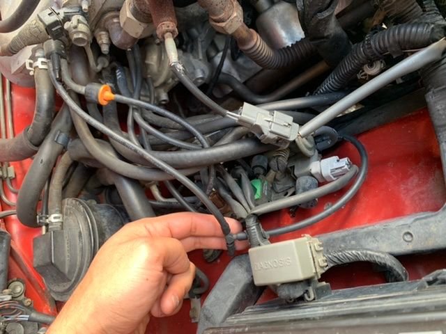

Here
is a better photo of its entire route. I don’t have cruise that’s for sure. Thanks for the info I just didn’t see this on any diagram.
