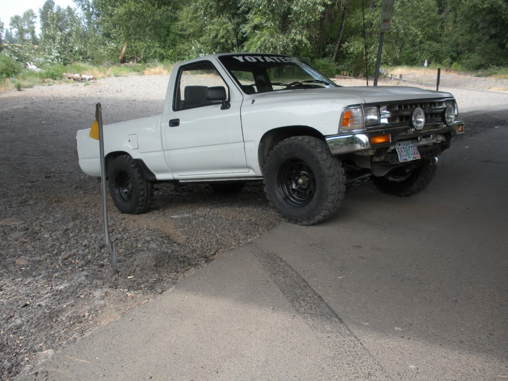

My truck keeps hitting the back tires and its messing them up. Every time I put something in the bed it hits worse on hard bumps.
What is a cheap way to lift the rear.
Do NOT say blocks because that would not be a solution.
I was thinking either shackles, add-a-leaf, or maybe new springs.
Thanks, Trevor

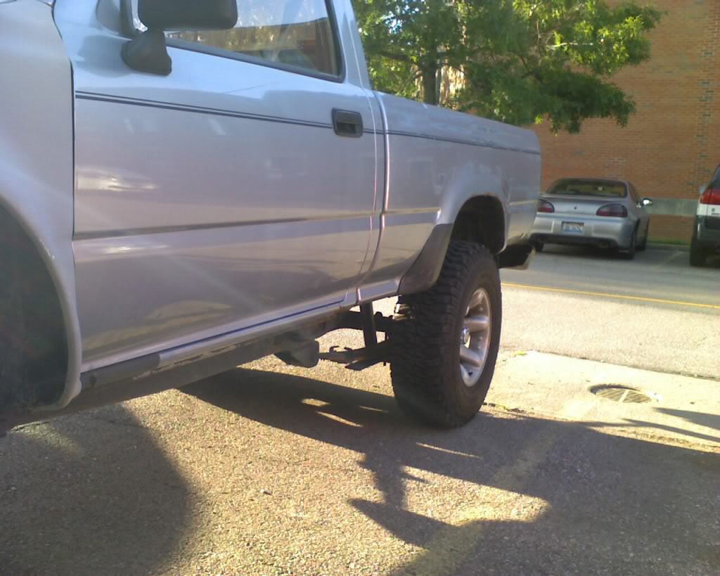

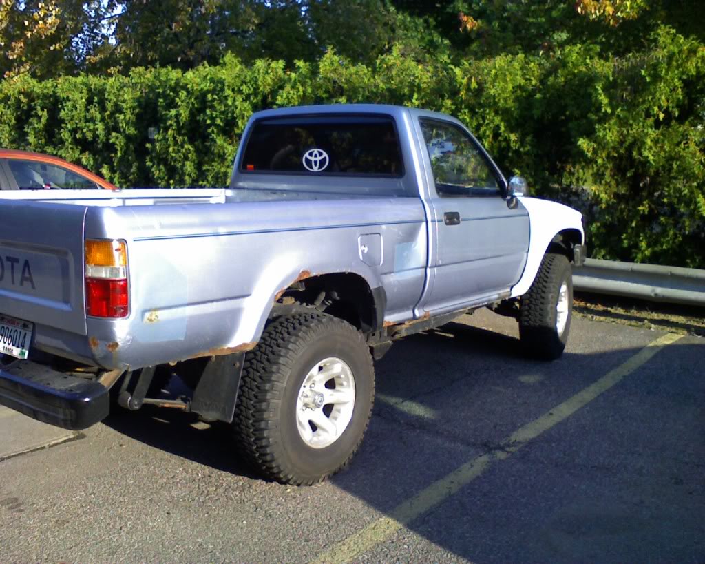

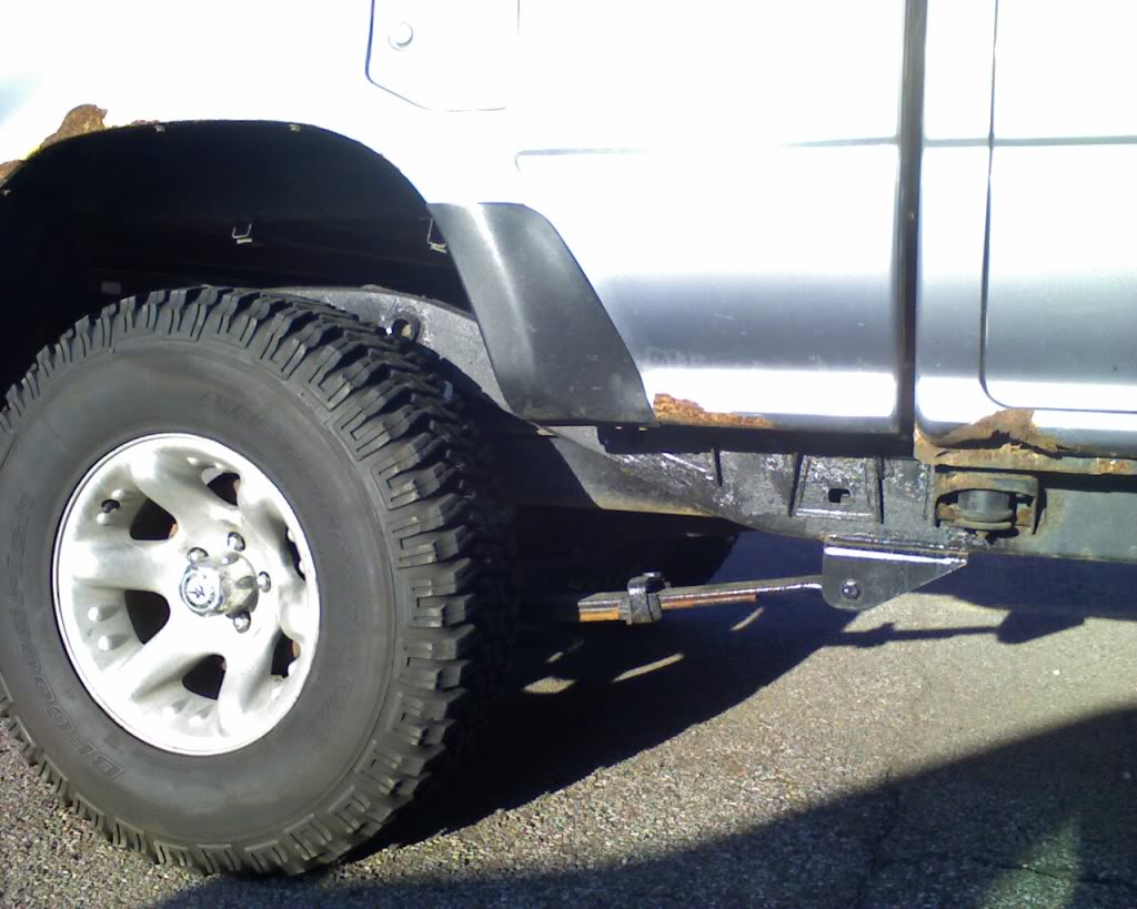

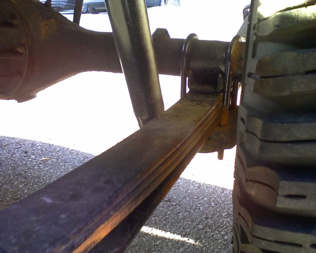

Well i would definitely have to say go all out and get the 63" chevies like i did for my 2WD. They are sick and the ride is sooo much better with them. Also the Axle is still over the leaf springs.
Before the Chevies
After WITH the Chevies
