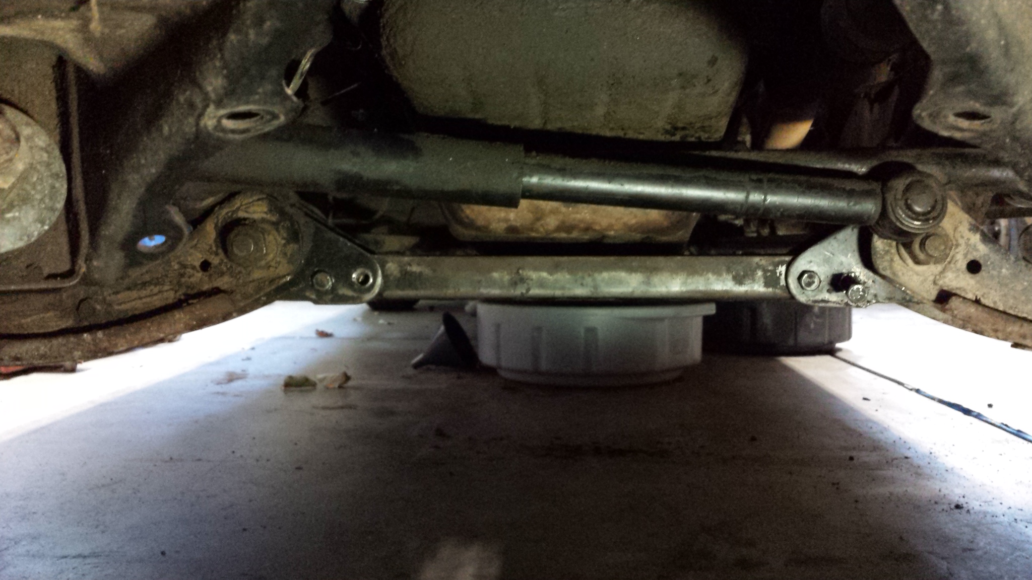

I removed my crossmember thinking I would be able to remove the oil pan with that gone....No Dice
The steering assembly is in the way.
I unbolted the motor mounts to just lift the engine enough to pull the pan out and before I lowered my truck off the jack stands I tried to re-install the crossmember and I was only able to put 2 bolts in all the way (one on each side). I got one bolt in partially but that's all I can do and now i can't remove it.
I've tried lowering the truck off the stands and one side at a time but no luck.
How can I get tthe crossmember back in? Help guys

Damn, my mistake.
I'm talking about the boxed support under the oil pan. It has holes on it and has two bolts with nuts on each side.

A long tapered bar, or tapered drift and a big hammer are what the Dr ordered.
You're gonna have to use some force. Pretty normal.

You use a tapered punch - the biggest (longest) one that can fit
You insert it in the hole and then "wiggle it" to get the holes linded up
And then you do ti again from the back side
and then the other 4 holes
and then start over (as the wiggling int he other holes will move around the first holes)
After several go around, the holes are all lined up
A second or third punch to leave "inserted" in the other holes shortens the number of go arounds you have to do

So this is normal?.....
Cool, I was worried I messed something up
Thanks guys
Here's the pic i promised for wyoming9 anyways. The bottom bar with 2.5 bolts in it
