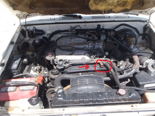

I just bought this 1989 Extracab 3.0 Automatic and just noticed that there is a hose missing. Can anyone tell what is suppose to connect to this pipe circled in red? Where does that pipe lead to?

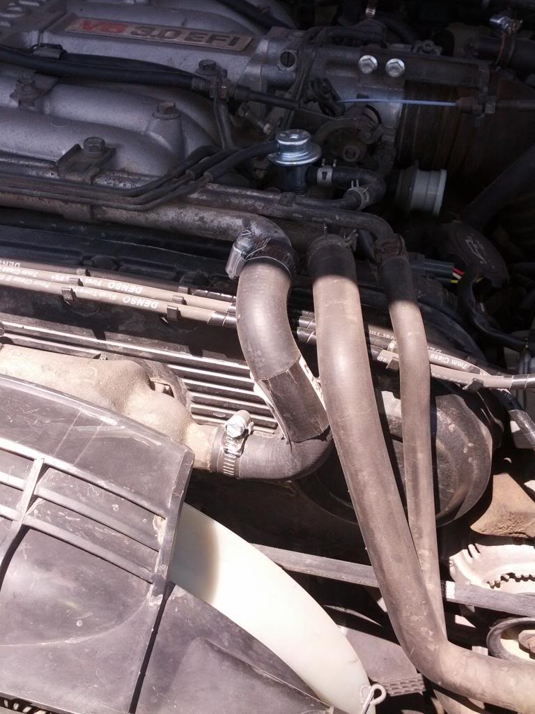

that is a coolant line

looks like yours is routed differently for some reason, the hose that goes across your distributor shouldn't be there

Interesting. Where does the line on the top go to? I don't know why it was routed differently.
