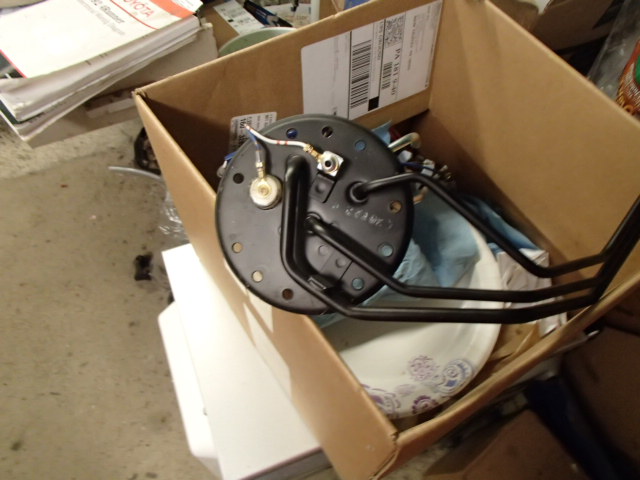

I have a new fuel pump bracket here to look at do you need pictures to look at .

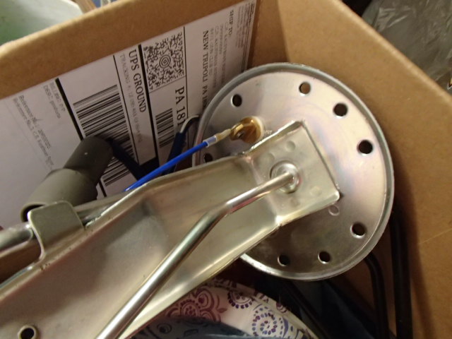

This is Fuel Pump bracket # 23206-35101
The picture on the left the positive wire is on the left on the right side picture the brass piece is the attachment for the positive wire
Like I said not a major project to run a insulated fuel proof connection through the bracket I would bet with some searching a product like this is ready made .
