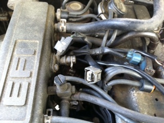

Can anyone identify this connector?
Hi all,
Working on a 1993 pickup with a 22RE. I cant remember if there were any unused connectors when I pulled the head off a year ago. When I put everything back together, there was an extra connector, and I cant figure out where it goes. There's only a few inches of play around it, as it is tied into a bundle under the intake. I've checked the connectors near the banjo bolt, as well as all of the injectors, and nothing's missing. The truck runs fine (after the past couple of days of work on it).
Is this simply an unused connector, or something I should be concerned about?
Thanks!
Doc

Looks like the connector for the fuel pressure VSV

Do you have AC? If not, I bet its the connection for the A/C Idle up valve. I don't have AC on mine so that connector is just left there unconnected.

see here (if this is the same as in my pic) https://www.yotatech.com/forums/f116.../#post51908600
EDIT: just realized that you are the same person I answered in your other thread.

I believe your right 92...for some reason I thought it had to do with the AC, but your pic shows otherwise.

yep..I have a/c.

yup, has A/C. What 92 said makes sense. Thanks!!
