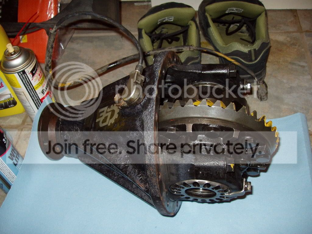

I picked up the rear 3rd today. Heres a rundown of what happened:
Tore the 3rd apart due to bad bearings, found that one of the side gears was literally welded in there. Gear guy had never seen anything like that before!
So on top of the new bearings there is new side gears aswell.
Hows the gear pattern look?
Run down of cost -
New factory 4.88 bearings - 180 ( ouch! )
Labor - 150
Misc parts (side gears, drive flange, abs sensor) 145
Of course no charge to install the lockright.
Im hoping to install these before I take a trip next weekend.

You got all the right ideas. The front will be more of a pain than the rear just because you have to a lot more to remove and re-install.
Don't forget to RTV (seal) the thirds to the housings. I wouldnt bother w/ new gaskets, RTV by itself is sufficient IME. You don't need to take the axles out of the rear housing completely but you can if you want. Its also a good time to check the inner oil seals (they're on the ends of the rear axle housing).
Btw its a ton of fun muscling the third members up in there, dont hurt your back doing this. It's an awkward position to be lifting a lot of iron.
