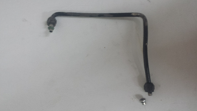

Hi everyone, I recently repaired my a/c system and it was leak free and worked perfect for a few months until a little misshap where the cap came off my battery and got battery acid everywhere. It ate through the discharge hose. So I ordered ordered the hose and a new drier. Started replacing the drier and the tube from the condenser to the drier just snapped. I can't seem to find the tube anywhere. Anyone know where I can buy it or what the part number is?<br />

Not sure if this pictured uploaded. I uploaded it using the yotatech mobile app. If it did, as you can see on one end of the line, the end broke off making it so I can no longer tighten It down.

88716-89132
http://www.toyotapartsoverstock.com/...rimLevel=18293
Are you sure the liquid line (from the drier to the evaporator) is okay? It sits right below the battery in a 3VZE.

It should be on the pass side on the 22r engines.

Thanks for the link ordered the line under the battery also just to be safe!
