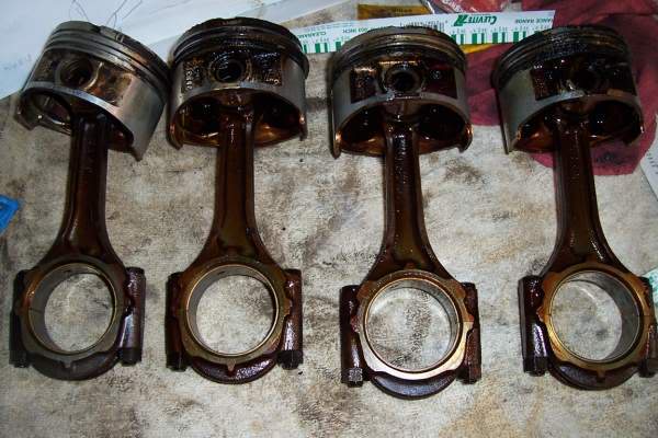

Sure, love to see your pistons. I have very little engine experience so I've been trying to learn as much as I can quickly.

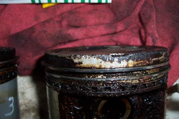

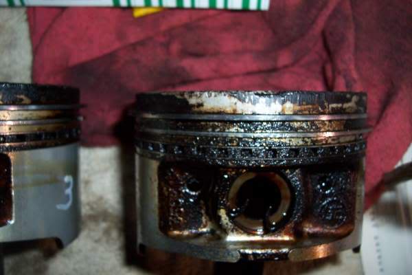

Congested/clogged/gunkified pistons. Note the bottom two rings you see on each skirt is the oil control rings.....also the filthiest ones. This should illustrate how you can still have good compression while the oil rings are leaking. The compression and scraper rings are all shiny on the outer edge from still being able to make contact with the cylinder. They weren't even worn beyond ring end gap spec. Really, the only problem was the sticky, leaky oil rings. Well, that and having thrown the timing chain....which forced me to completely rebuild.
The carbon builds up on them from blow by gases and they no longer expand completely flush against the cylinder wall to seal as well. Mine were all pretty much the same, but I'd already started cleaning one of them when I took the pics. If you have one, and if you rebuild at some point, use a bench grinder with a brass wire wheel. Cleans them up very fast without taking off the aluminum.

Right....carbon build up. That one slipped past me.
Well, you saw my pics. That was after several Seafoam treatments. Didn't do much good, I'd say.
