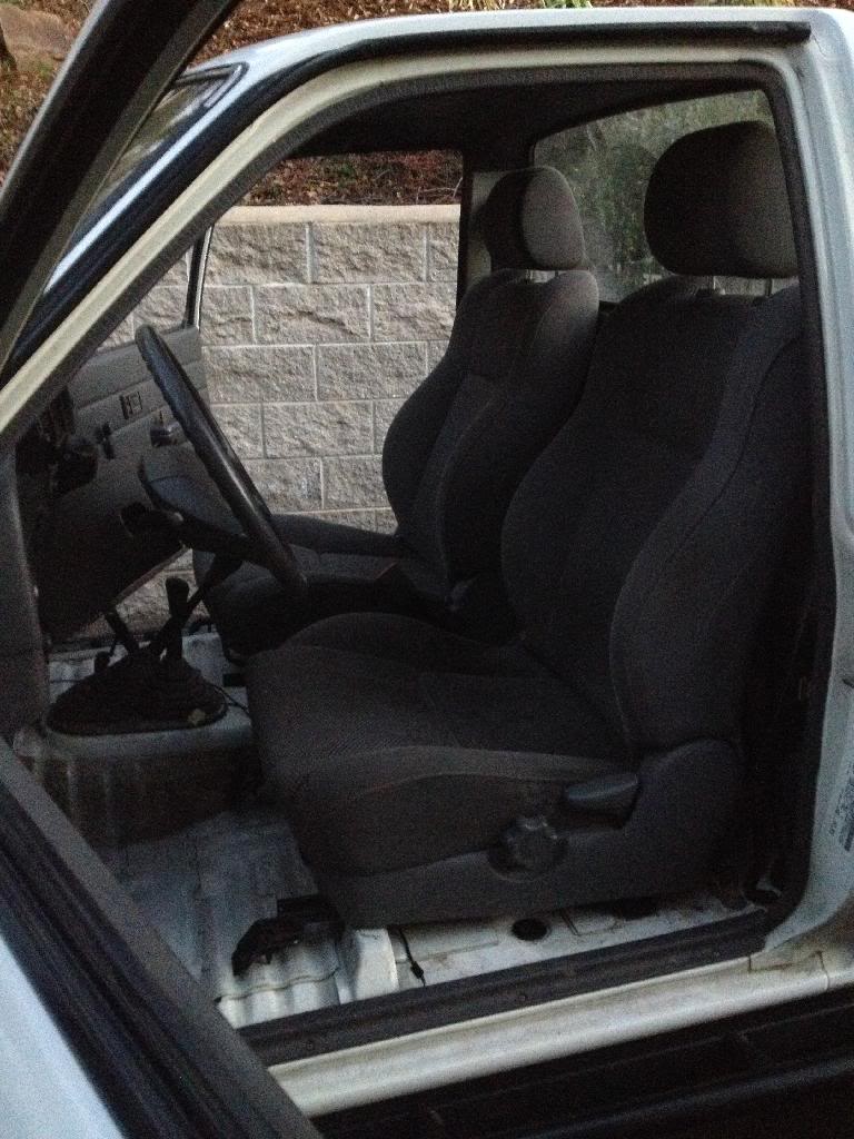

2007 Tacoma seats in a 91 standard cab.
They fit perfectly, but require custom mounts.
did you lose any leg room? my in-laws tacoma needs new seat badly and these look awesome - i know they feel comfy since my SIL has an 05 Taco. when i did this to my old datsun, i lost about 1-2" of leg room - very noticeable if you already use the seat all the way back.
A bit, but hardly noticeable to me. I can move it all the way back at the same angle as my stock seat and taller drivers fit in just fine.

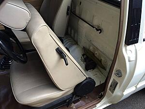

I used some seats out of an e30 BMW in my 2wd 1986 standard cab. NONE of the holes lined up so we used 4 pieces of square tube welded to the floor of the cab (reinforced, of course) as mounts. If you're not familiar with early BMW seats, they're pretty slick and can be raised, lowered, and adjusted forward and backward.
If you get them from a coupe, they sort of raise and fold forward to allow for extra storage behind the seats. I have put my husky tool box (flat kind) and a Pelican rifle case behind mine.
Another great thing about them is they match the era of the truck, and look factory. To me that's huge.
Here are a couple pics.

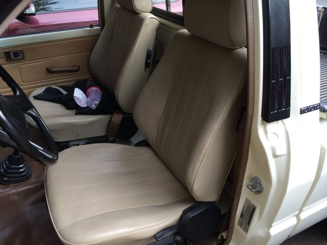

I took your advice Gevo and re-upholstered
Looks like lots of legroom!
Attachment 100466
Your seat looks great! How much did it cost? The reupholsterers here that advertise seem to do mainly vintage car$.

$350 did some reinforcing into spring webbing also,thinking about having door panels done to
