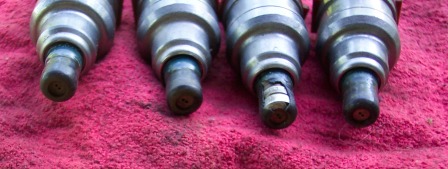

I took my injectors out today as a last measure troubleshooting effort. One of the pintle caps is cracked in half and missing. A second injector shows cracks in the pintle cap as well. Two questions:
1. Would the broken/cracked pintle caps be cause for the cylinder to not fire properly?
2. For those that have sent their injectors to be serviced (witchunter.com), is it worth the time and money to have these serviced?

No, you could take them off actually and the truck would still run fine. But, this does make a person wonder how well the injectors are working. The only problem is that if the engine was running well before you started rebuilding that it's unlikely the injectors are bad. However, I do recommend cleaning injectors. It made a nice difference on my 22re.
