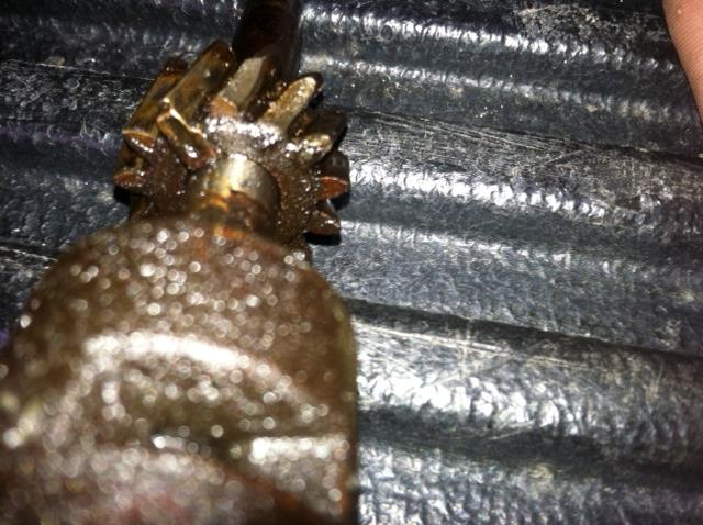

I finally got around to pulling the distributor out today, and found this:
I cant see any metal inside the engine. I'm GUESSING that the shaft moved a little and the gear was only engaging halfway.
Off to order a replacement.

So here's where I'm at with this. I ordered a used dist from ebay for $40. Its supposed to be in good working order and is a OEM toyota part from a 90 4Runner. My thinking was I'd rather try a cheap dist first, so if I find there is a problem with the cam or something else I dont ruin a $500+ dollar dist.
My worry is, where are the missing teeth from the broken dist?? Did they make it to the oil pan, or are they laying somewhere waiting to cause more damage? I plan to run a small magnet into the dist housing to see if the are there, and then pour some oil in the housing to maybe push any metal into the pan. Change the oil, install new dist and cross my fingers.
Has anyone seen this kind of thing happen to a distributor?

Those teeth could be anywhere, but most likely still in that valve cover. I'd pull that asap and try to fish them out. Otherwise, they risk migrating elsewhere in your engine and doing A LOT of damage...

I changed the oil, after pouring some into the dist housing to flush anything that was in there to the pan (hopefully). I kinda jiggled the oil drain pan to try and hear if anything solid was in there, but couldnt tell.
Everything seems fine so far. I did figure out what caused all of this.....the shaft the gear is on froze up.

It's definitely a heavier metal. Feels like steel. And checked my factory original that had a sensor go out on it with a magnet -- and it's magnetic. So steel -- probably hardened less than the camshaft in the event of this failure, but still...
Why does the camshaft matter? The distributor gears connect to the gears in the front of the drivers side cam:
Connects under the front bearing cap:
The front bearing cap probably still contains most of the bigger shards, as the valves are further back, but oil flows from that front beaing cap to rear over the top of the drivers side head, which means that metal is probably slowly migrating its way across all of the valves before returning to the pan... So my recommendation would be to pull the valve cover and bearing cap(s) and get it cleaned out ASAP, and see if you need to replace the cam should it be damaged -- damage which might also be tearing up the gears on your new distributor. Those metal shards are in that engine somewhere. Lying in wait (or possibly silently, but actively attacking)...
