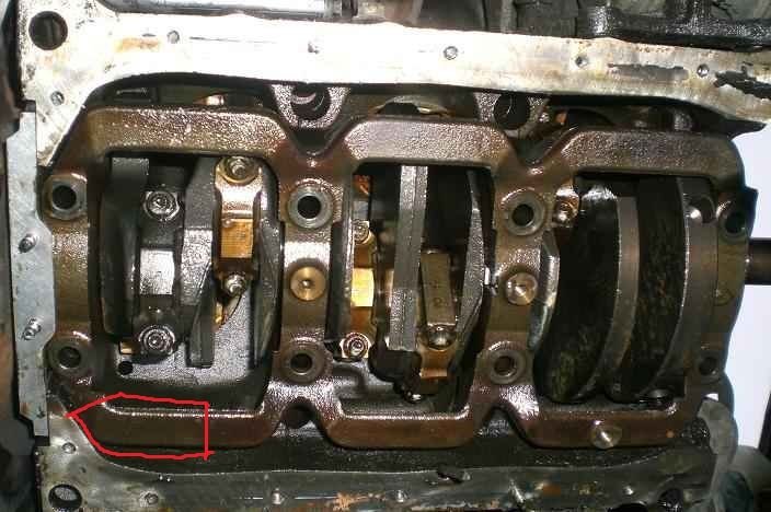

An image would help to judge the damage.
I think that each one of these main bearing girdles is matched and line bored to its specific engine block.
They are made this way so as to make the lower block/main bearing line more rigid under load.

Sorry, don't have a pic of the actual break, but this section outlined in red is where the break is:

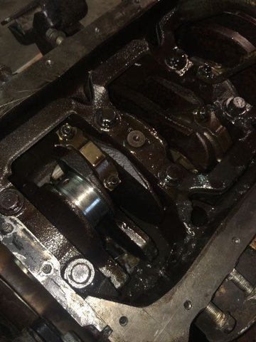

That's what I'm guessing also, which is probably why I cant find a part number for a replacement. So i guess we'll have to find a cheap long block or short block and rebuild that.

Here is a pic of the break
