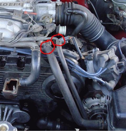

found a picture in Google images...
...easier than taking one the ones circled in red are the two that I can't identify.

That's part of the PAIR system. If you don't understand it, you shouldn't try to bypass or change it.

The PAIR system injects air into the exhaust to help burn any unburned fuel. Won't affect performance to keep it or remove it. You may run into trouble with emissions tests though if you remove it, so I would leave it in place.

The larger hose circled in red on the left feeds filtered but un-metered air to the PAIR valve. You can eliminate the resonator (plastic box lower right in the picture) and route a new hose from the PAIR fitting you circled straight to the top of the air cleaner box. That removes some engine bay clutter without risking emissions testing issues.
