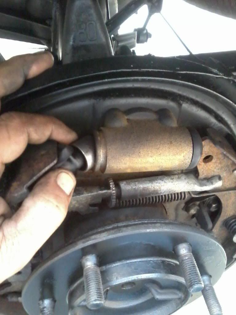

You can buy an Aisin online for about the same price as parts stores. I have not had much luck on clutch or brakes cylinders from parts stores.
Also Toyota used different sized cylinders for the same generation. Pay attention to which one you have.

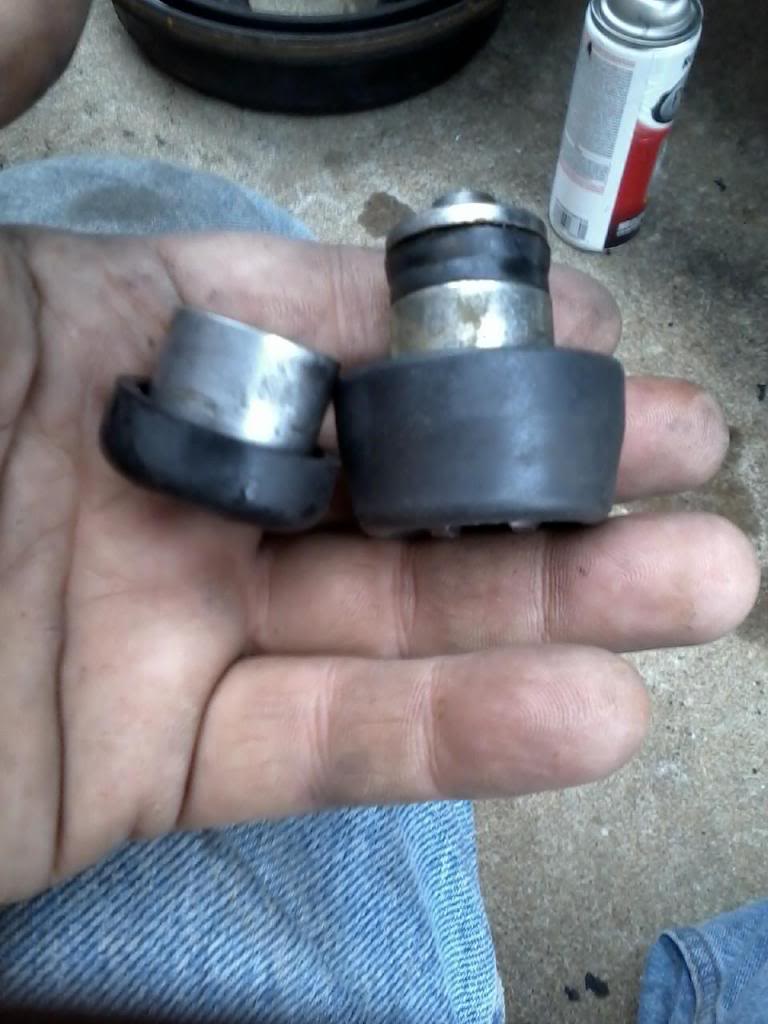

What happedned to me is I put the smaller one on when I should of used the larger one. I was unaware of that Toyota used both styles. When I had the wrong one on, the piston popped out and I lost brakes. Luckily there were was no traffic at the bottom of the hill and I was able to blow thru the stop sign. It was an exciting time to say the least, but could of been a bad situation. It is posted in my 86 runner build somewhere in my link below.
My 88 runner uses the smaller cylinder but my 85 and 86 uses the larger one. Toyota does some screwy stuff. I just bought an AC drier and depending on which month of 88 determines which drier you use.
When you do get new parts, always compare what you get to what you have. I too have been getting more parts from Toyota or OEM dealers online. Ebay, Amazon, Rockauto.. are just some of the other sources I use.
Here is what happened. I lost all brakes at once. Drivers side leaked and I just changed it only. From now I compare to the oppisite side if swapping parts.
The piston would not stay in.

The one on the right is what I should of had all along.
