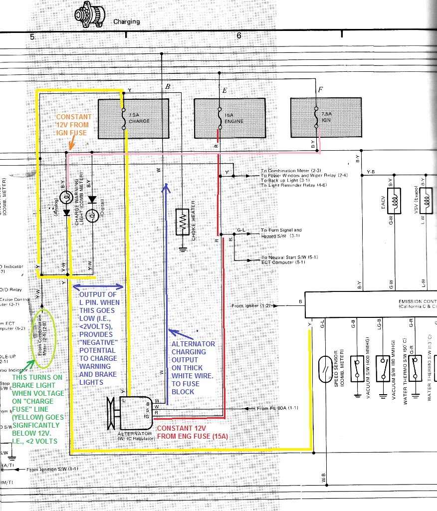

Originally Posted by Shooter1292
I'm thinking that sounds like a good next step. I checked the ALT plug for corrosion and it is clean as a whistle. I'm going to ohm out the yellow wire.
Quick Check Point...
That should have 12 volts while engine is running. If it doesn't, check other parts of charging system as described in my thread. Search "How Charging System Works"

Originally Posted by akwheeler
try hooking it up to another vehicle with jumper cables, both running, but with your alternator disconnected. no funny lights means you need an alternator. or you could take yours in to have it tested, some parts stores can still give them a full test and let you know if a diode is bad.
If alternator is disconnected you will not have get charge error light because there is no "L" wire to bring the negative side of charge and brake error lights close to ground.
However, I agree with having alternator tested.
WHEN THERE IS 14.7V at "L" (yellow highlight, charging voltage in normal range) on the negative side of the charge and brake error lights, the only way for charge and brake error lights to come on is
1) IF the positive sides (pink highlight in schematic) connected to 7.5 "IGN" fuse were much greater than 14.7V,
OR
2) If the diodes in combo meter (dash) were bad, and the voltage at IGN switch were much lower than 14.7V. But then, the truck should not run in this scenario.
