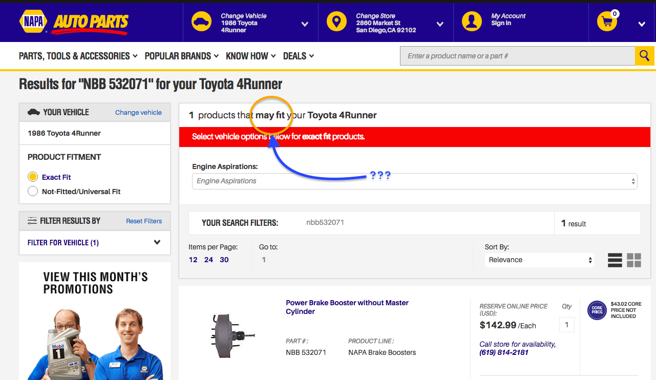

Anybody had luck with NAPA boosters? Website says PN 532071 ($143 after core refund) MAY fit my 1986 22RE.
I have intermittent issue where it feels like there is a "notch" that catches, then releases when I press the brakes (no problem stopping the truck). I tried with engine off and could not make it happen so I also suspect defective booster.
However ... LOL!
Originally Posted by scope103
...cue Rad4runner's rant about replacing parts at random ...
I want to inspect first before buying the part. I have not taken the system apart before so I'd like to ask if it is labor intensive (or messy?) - which would warrant having replacement part ready if I find it defective. OR is it pretty straightforward that I can simply put things back then order parts if needed?
Video of intermittent problem:

It definitely sounds like something is hanging up. Have you made sure the sound and cause of the hang-up is not in the pedal assembly inside the MoreFunner? The sound it makes in the video does sound like it's in a metal container (like a brake booster).
Does this happen every once in a while or can you make this happen predictably? I have to agree that the brake booster sounds suspect, being that it only "acts up" when the MoreFunner is running and vacuum is supplied.
I replaced my brake booster by removing the brake master cylinder, and the brake lines going to the master cylinder. This can be messy (keep brake fluid off of paint!) and you will need to bleed the brake master cylinder and the rest of the brakes when done.
Some people (and depending on the vehicle) just unbolt the master cylinder and with the lines attached, just bend the lines forward so the brake booster has the clearance needed to be removed. I didn't want to take a chance ruining my lines so I took the more messy route (I was also replacing a leaking master cylinder, so I had to remove it anyway).
I have no input on the NAPA remanufactured booster.
I was lucky enough that Aisin still made a booster for my truck even though all others have pretty much been discontinued by both Toyota and Aisin so I didn't have to worry about possible marginal part quality.
