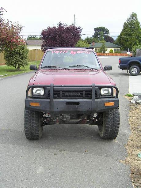

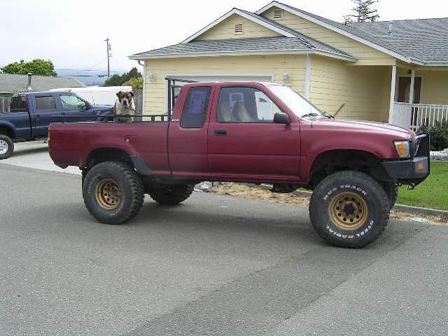

Ok here it is. I got the 4 35's for $50! The rears are different from the fronts but the rear have like 1/4 tread and the fronts are pretty worn. I am going to run them for a couple months then get some new ones and use one for a spare. I am really stoked on how it turned out! I am going to take it out to the river bar later on today. I will try and get pics out there and post them up tonight. I still have to paint the rims black so no making fun of my blingn' gold rims. LOL

Looks good man! I actually kinda like the gold rims...
You gonna do something about that rear sag or am I just lookin at the pic wrong?

Well the front has about 5-6" of lift and the rear only has a 4 inch block..... But I plan to do some chevy 63's and that should fix it. But I want to keep it as is for a while so I can wheel instead of work.

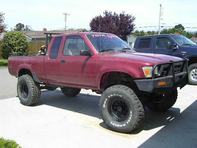

Be careful with the axle-wrap those blocks will create on the stock springs. You don't want to crack a leaf on the trail and have to limp your way home.
I only wheeled once or twice with blocks before getting the lift springs and it was miserable. It really plays with your traction and power.

I used to have a standard cab yota with 4 inch blocks in the rear and never had a problem..... Maybe I was lucky, I will just run this tell it brakes or tell I feel like getting chevy 63's.
Here is a pick with the rims painted black.
