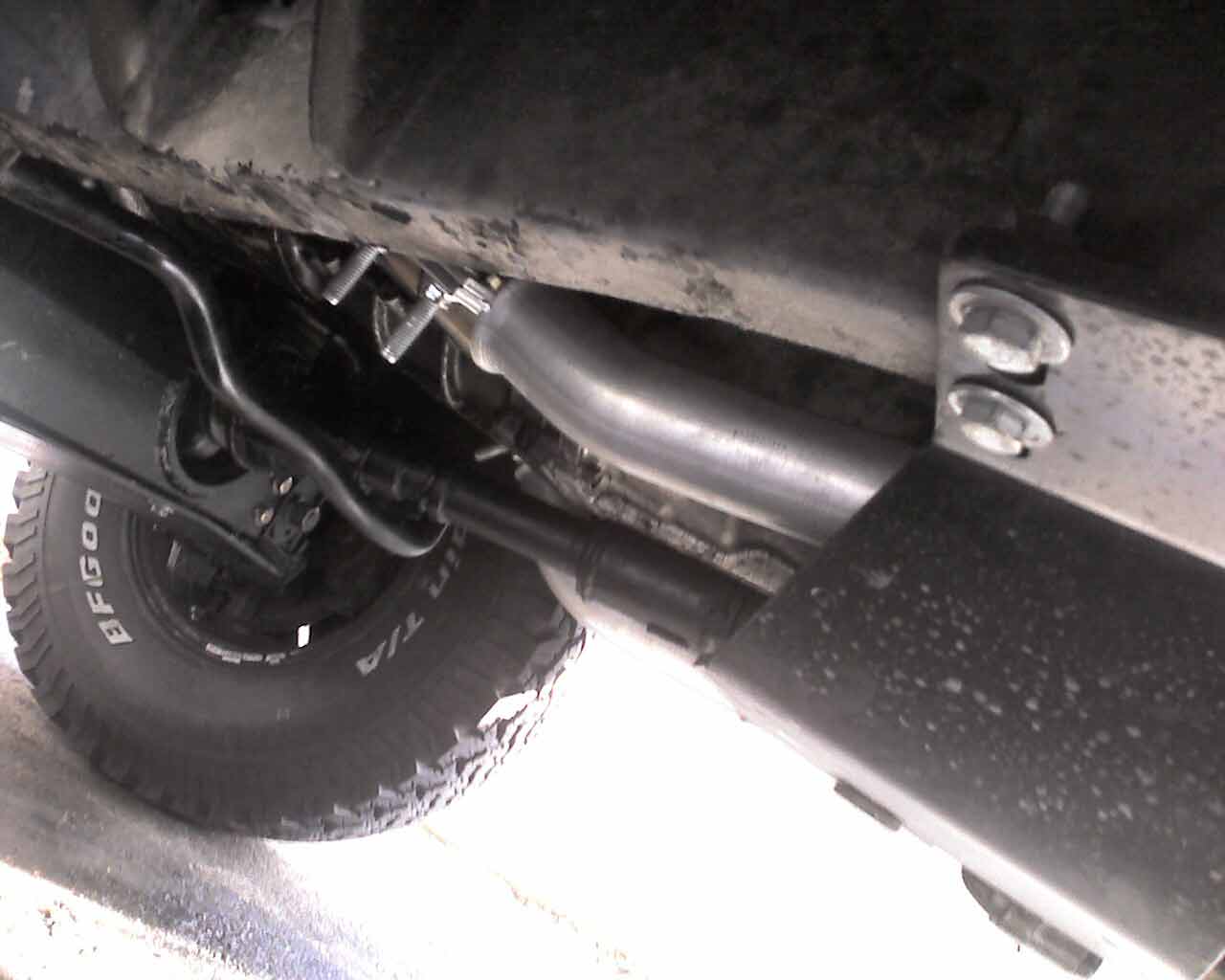

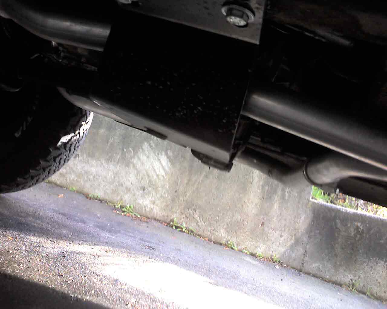

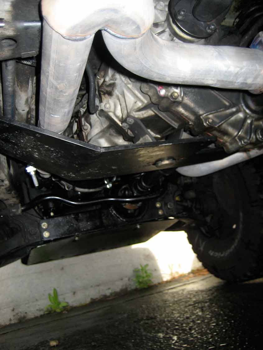

budbuilt xmember skid challenge- which way does it go!
this is for the parts that Bud calls BBV6S , the only link I found for these is here:
the crossmember is installed already, looks great and I gained a LOT of clearance. Eddie@Stan's rerouted the exhaust above the budbuilt xmember and it is just great. problem being that the skidplate absolutely does not seem to be the right part! I wrote Bud but he told me that it is the right part.
I'm putting 6 shots to give you an idea, and the question is, which way does this fit? in the hardware box there is a spacer too, does the long end of the xmember skid go on top of the sonoran truss and under the front ifs skid (sandwitched between them?)
Attached Thumbnails Boyle HD Rebuilt Alternator (pics)-xmember-first.jpg   Boyle HD Rebuilt Alternator (pics)-xmember0.jpg   Boyle HD Rebuilt Alternator (pics)-xmember1.jpg

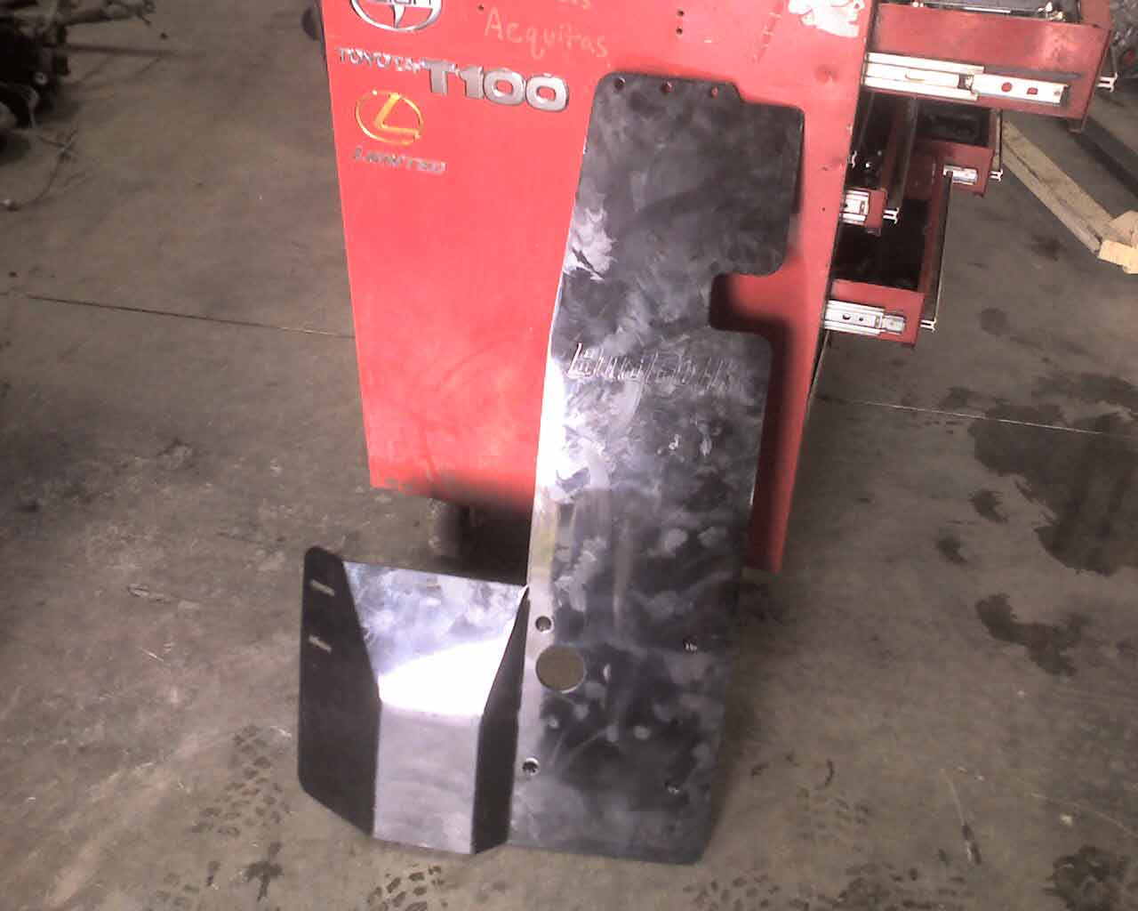

more pics of xmember and skid
xmember is already installed, the part propped against the tool box is the xmember skid that is supposed to install on top of the xmember somehow, but I think it may be the wrong part.
Attached Thumbnails Boyle HD Rebuilt Alternator (pics)-xmember4.jpg   Boyle HD Rebuilt Alternator (pics)-xmember3.jpg   Boyle HD Rebuilt Alternator (pics)-xmember2.jpg

The big hole in the skid goes over the exposed tranny mount "bolt". The 4 small holes should line up with matching threaded holes in the crossmember. Otherwise, it looks like he's changed the design a little and extended the "nose" to protect the driveshaft - a feature I wish mine had.
If yours is like mine, there's a little square tube and longer bolts that go on the side where the tcase droops down (and the little bump in the skidplate). Put it up there with the crossmember bolts lined up around the tranny mount "bolt" and see where stuff lines up to...

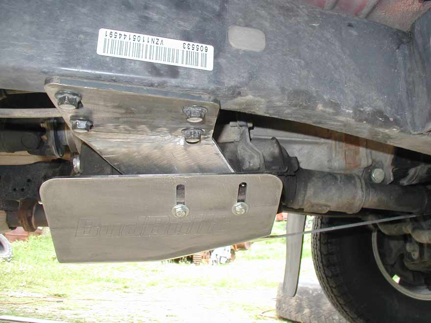

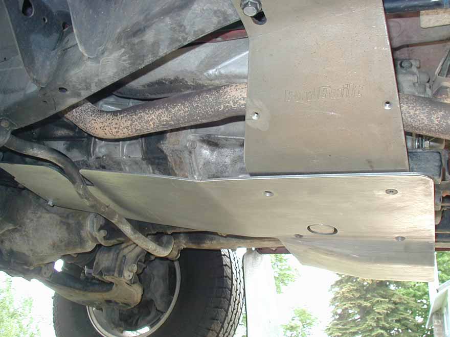

pics of the budbuilt BBV6S singlecase xmember skid
from bud this morning! deathcougar what do you think?
Attached Thumbnails Boyle HD Rebuilt Alternator (pics)-bbv6sa2.jpg   Boyle HD Rebuilt Alternator (pics)-bbv6sa1.jpg   Boyle HD Rebuilt Alternator (pics)-bbv6srear.jpg

Yep, just how I described it. You can see the little piece of square tube in the third pic on the right side between the crossmember and the skid.

Perfect, now I can see how it all goes together. The long piece points forward, and goes up above the sway bar! I didn't even think of that. I wonder what it bolts to under there tho, as far as I know there are no holes on the bottom of the trans to bolt to?

Well we got the skid plate installed, but the front doesn't appear to bolt to anything? Where does that front bolt go to, the bottom of the transmission? Are we missing a bracket?
See the front bolt at the front of the skid plate? Only the far right bolt it bolted in, yet there are 3 holes. What the hell does that far right bolt screw into?!
That's about where the rear crossmember (like Sonoran steel) should be - maybe it would bolt into that somehow?
I know Bud doesn't really say that a Sonoran crossmember is required for his front skid, but it (or something like it) REALLY is...
