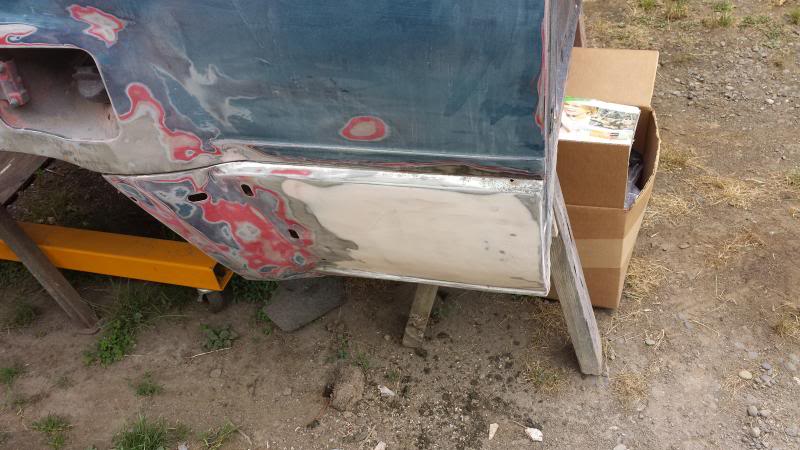

Can anyone tell me what the plastic piece that goes to the left of the bondo patch on the bottom is? And maybe where I can get new ones.

I've always seen them called a "gravel shield" or "gravel guards". 4Runners had them too but they don't interchange with the pickup. I've always heard that they are a discontinued part. Your only source would be used but they usually crack when they are removed so I never see them offered here or on eBay. I cast new ones for my 1st gen 4Runner using the cracked ones as a mold and using epoxy and fiberglass mat. I'm not sure I'll use them cause I already closed the old holes and they collect dirt and rust.

It's called a quarter wheel house cover, PNC 62613A(RH) & 62614A(LH). They are still available, in atleast 3 different colors(black, white, or light yellow). I see them listed for sale on atleast one OEM parts distributor's website. For ~$38 + shipping.
http://www.toyomotorparts.com/
If you don't desire a totally stock appearance, those holes can be easily filled and painted to match. That's how my 88 was when I bought it.

or also comonly known as "rock chip protector" ..
used in that specific spot to stop rocks from "sandblasting" the paint

MudHippy is the man! Armed with the correct name, "quarter wheelhouse cover" I found them for $34.64 in white, black and silver at
http://www.toyotapartsoverstock.com/...ssembly=491443
Sorry to hijack the discussion about door skins but maybe the link above will help someone before they weld up their holes.
