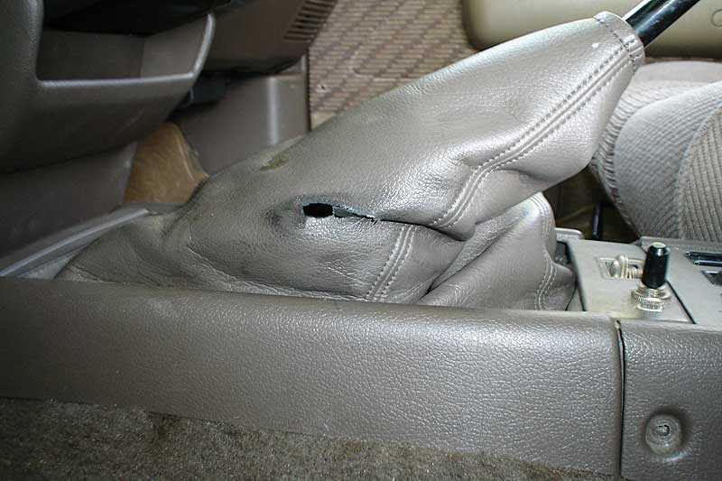

So I installed a 2” body lift on my 4Runner a few years ago. I noticed the shifter didn’t sit as high in the cab. The shift boot was also rubbing on the plastic interior trim. This caused the shifter boot to get a wear hole in it. And shifting into gear was a pain in the ass. So I trimmed some sheet metal and moved the black rubber shifter boot/seal back a little. This fix helped some but it still wasn’t that great.

Before: You can see how low the shifter sat.
After: You can see how much higher it sits and the wear mark from before.
